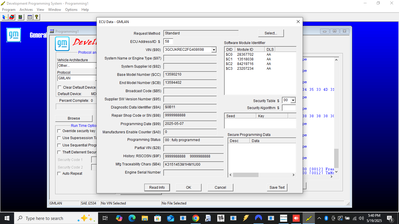

How do I figure out if its the 2 byte or 5 byte? Its not giving me any numbers under the seed.

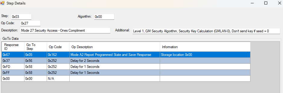

    I retreived the SDM calibrations of this vin, and uses table 00 and algo 00. try it in DPS to see if drop a seed/key

If you have the Utility file you can check if its 2 or 5 Byte, but seems not have Security access

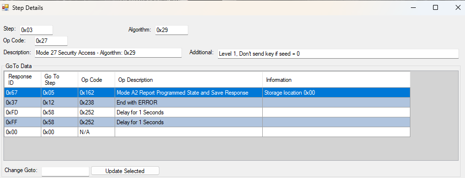

You need to put an algorithm in there otherwise it won't output anything. Try 0x29, that's from a 2019, it might be the same. Put that in the box, do a read info then it should give you something back in seed/key.

I have the same SDM, their version of DPS we've found is good. It's a bench setup and looks like it's not happy with something. They were trying 83.3kbps but I said to step down to 33.3kbps. At that point, the SDM is responding with "Conditions not met" after the security access request seed. I'm pretty sure it's unhappy with being on the bench, possibly not having enough inputs connected or something. I've downloaded the CALs for that one and mine, our utilities are the same and I can get a seed from mine. Also, this one uses one's compliment instead of the 0x29 that the newer Sierra's use. DPS would just give the wrong key back though if 29 is entered.
