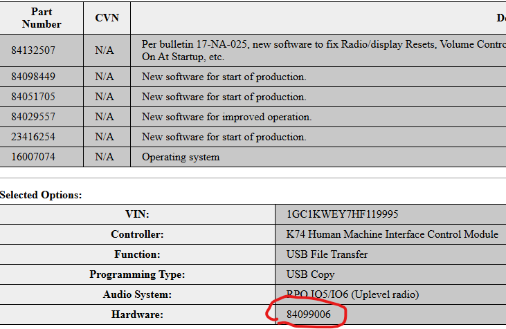

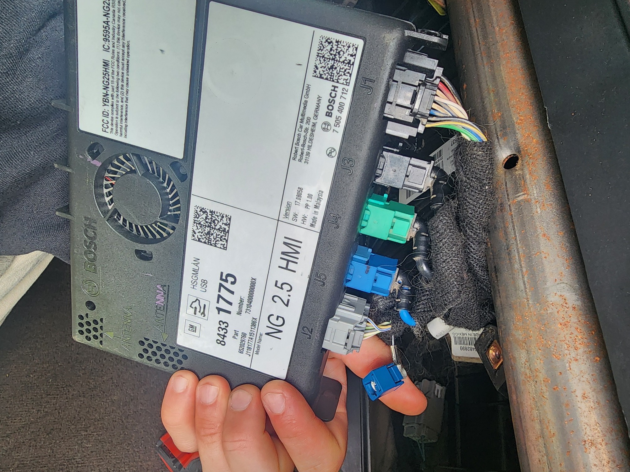

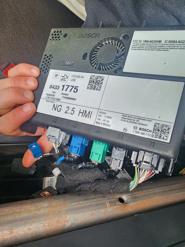

What is the HW number?
Its 84331772 but really i'll try files from any io6 system that has carplay and android auto lol
Update... customer is an idiot and got a non-nav HMI.... I ordered the correct HMI and will attempt the USB update then to see if it has the map files.
