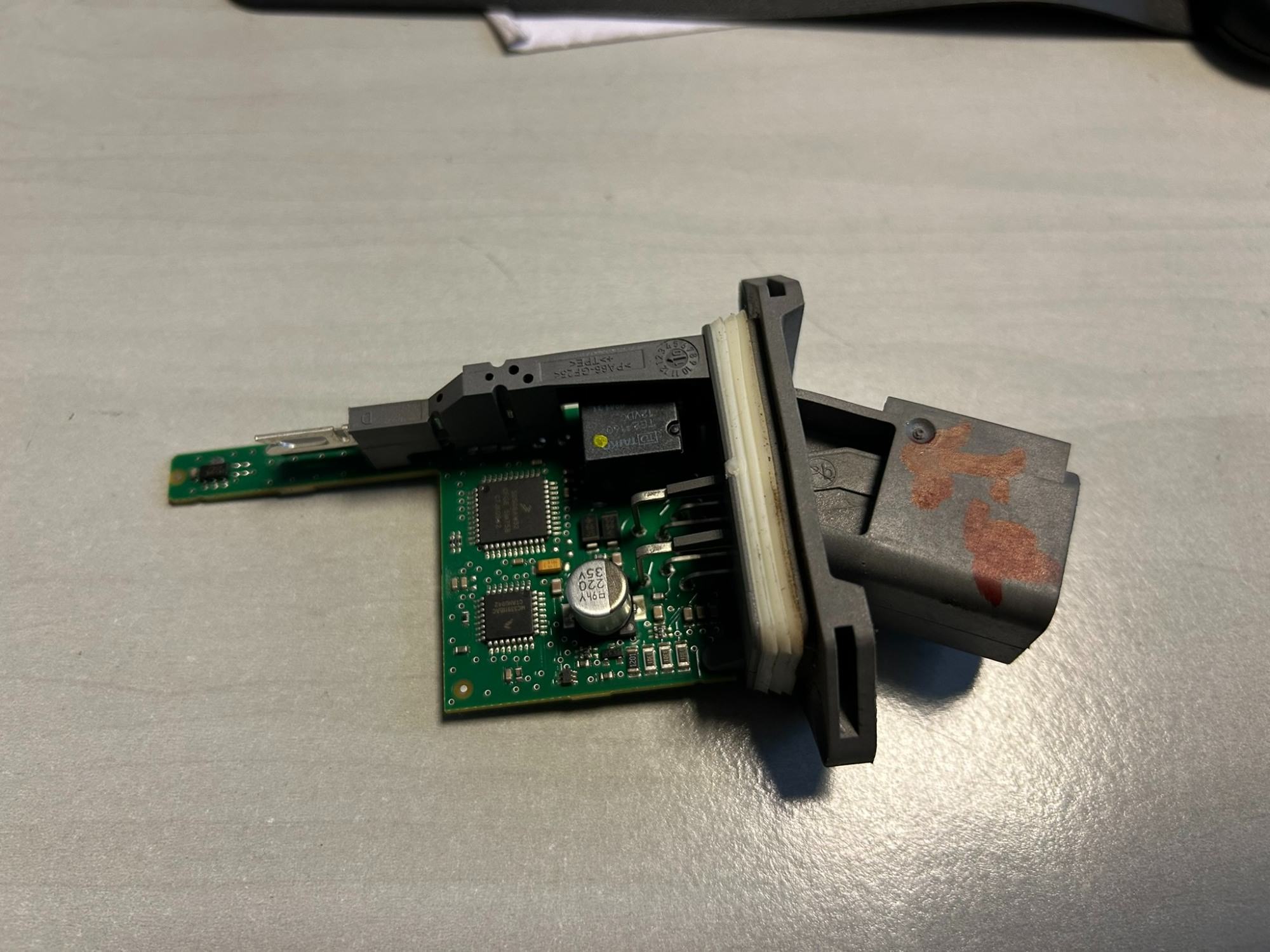

Hello, is it possible to change the software in the Opel Insignia window regulator module to change the UK to the EU ?

  • this modules are controlled via LIN BUS from BCM. i think you cant change the software at least via SPS/dps
Was there actually any difference in window regulator module software between UK and EU? Is it LHD/RHD thing?
Of course LHD/RHD, it's generally the same thing. If we put a module from the UK to the EU to the front left one, two windshields are lowered at the same time.

Is it possible to reprogram UK to EU?
Or Right to left?
