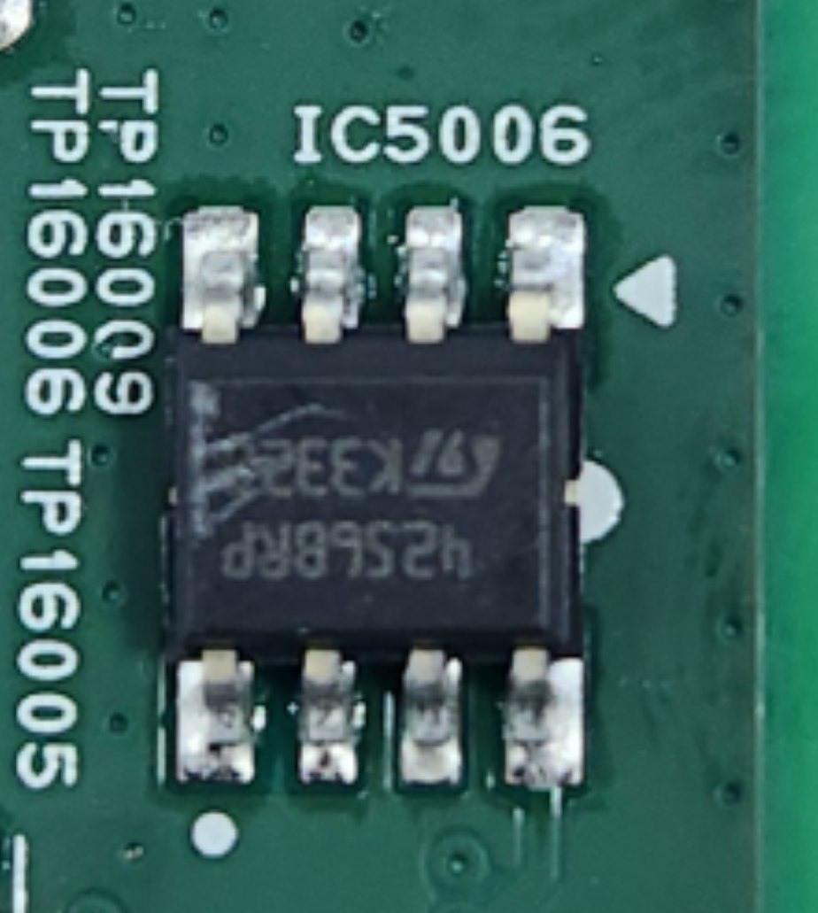

I need your help, who knows how to find a programmer to read this chip ST.        4256BRP.

  • The ST 42568 RP is a 256-Kbit serial I2C bus EEPROM . Replacement should be M24256. You can use TL866 or any similar which work with this IC.
