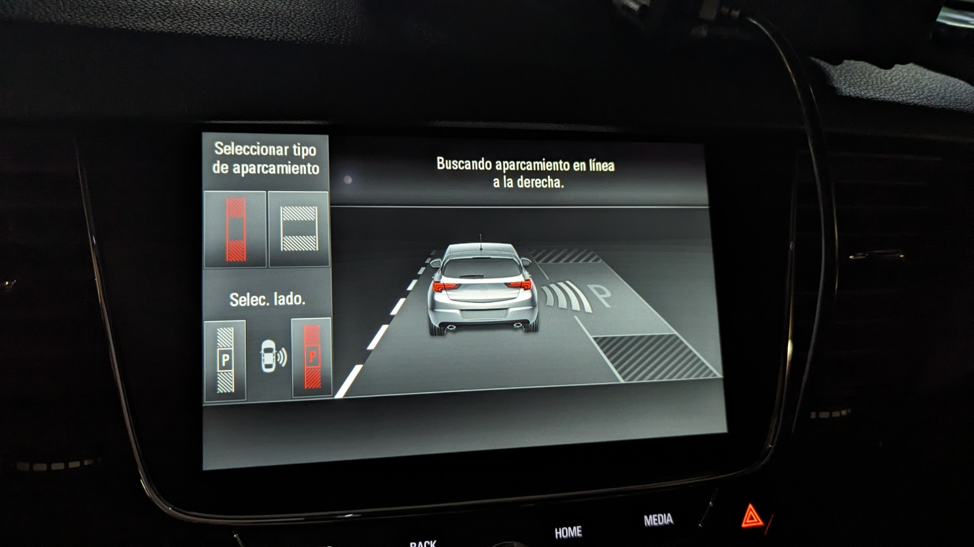

Hello, i am searching a Solution for Auto Parking on a IOU Display. At the moment the "Auto Parking" comes on the IPC. At the Faclift Astra K an d Insignia B comes that all on the IOU Display. Have somenone an idea or a Solution ?

  • If you are referring to where the directions come from, in Astra K if you edit the XML of K182, you can make it appear either on the radio screen or on the instrument panel. This is because there are
  • Hello Thanks i solved it 😉
If you are referring to where the directions come from, in Astra K if you edit the XML of K182, you can make it appear either on the radio screen or on the instrument panel. This is because there are cars WITHOUT a colour speedometer, and the directions are given on the radio screen. I was talking about this with @Robi_X some time ago.
