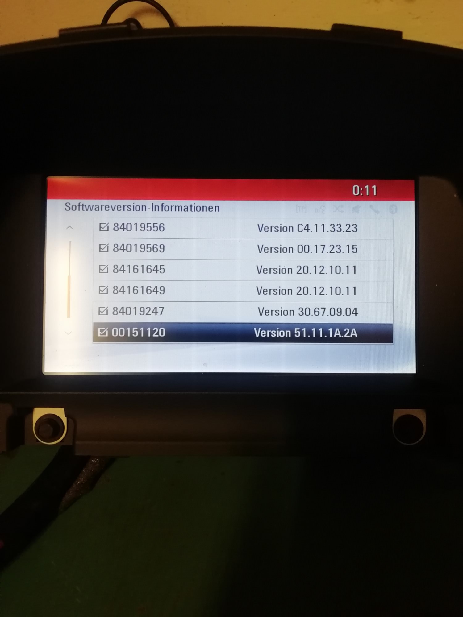

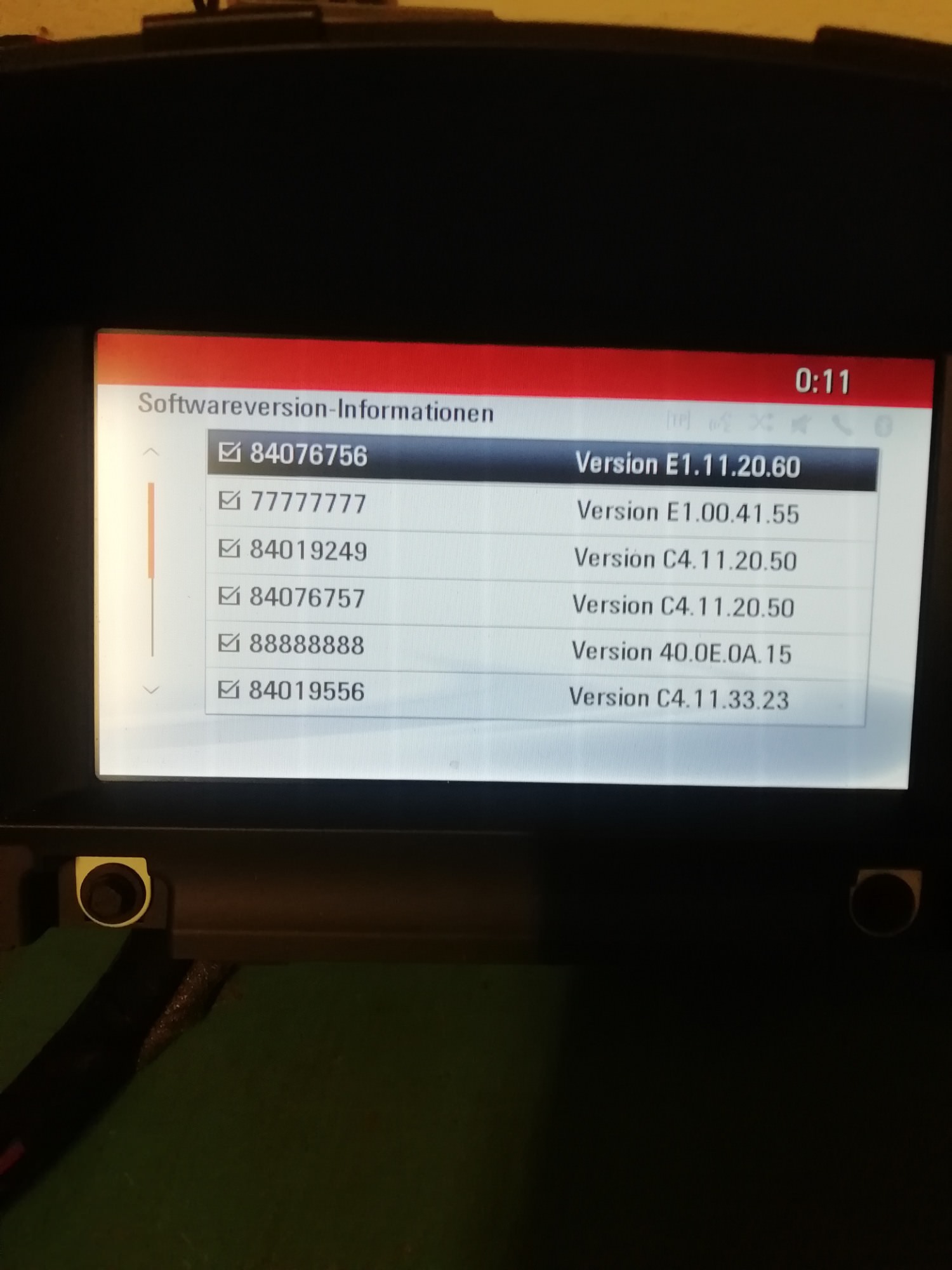

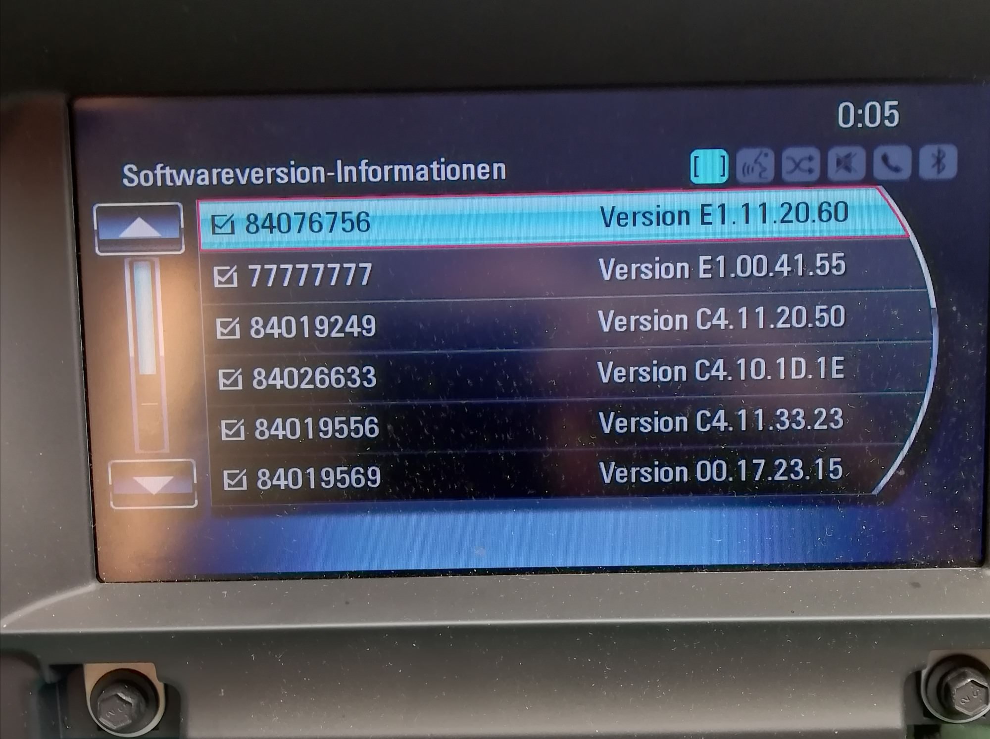

I think they are. I have photos with software version information, how else could I check it. I can send
