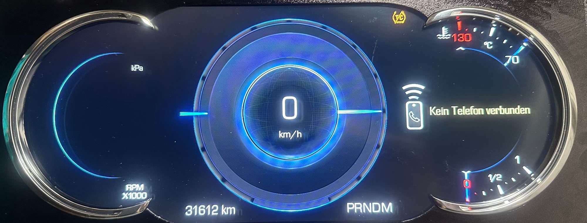

i messed up when i was trying to read the eeprom and now it shows only a blank page with the speeddometer.

the ipc works in the car. it looks like the theme is changed.

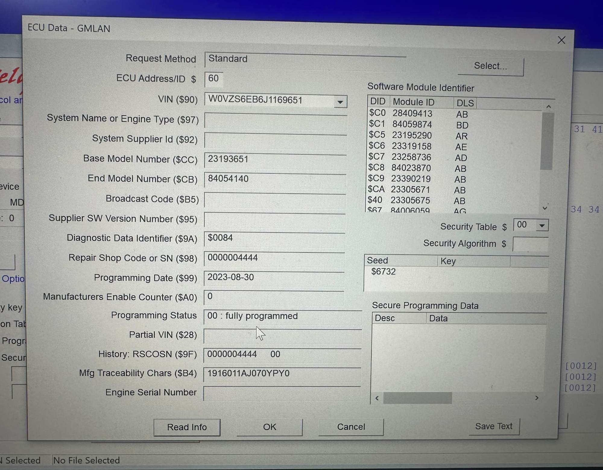

change the DDH_Variant in XML or restore the default XML onto speedometer
yes i already did that and it worked as far for the theme. But alot of functions aren't there anymore. i used the xml from the cadillac 2015 file which you can download here. therefore, i thought i need the right XML for 2017 onward but i can't find it anywhere.
