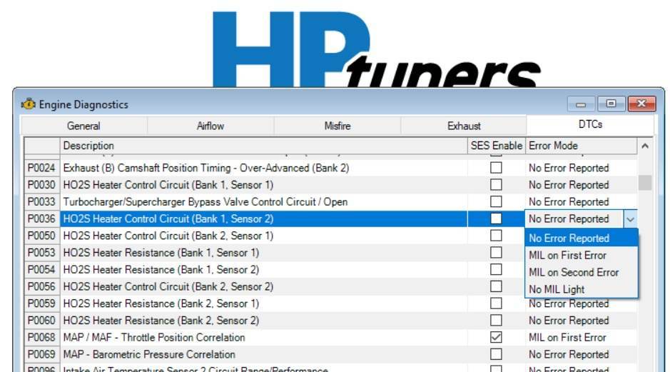

Hi, brother if you are asking DTC related to Engine and Transmission then yes its possible, you need to have Hptunerrs or Efilive,
Last Captain, thank you...
I have done this already, but the permanent code remains... Check engine light doesn't come on anymore, but permanent code is still there.
you set it to " NO MIL "
SET IT TO " NO ERROR REPORTED "
Thank you again,
Yes I'm certain it's set to No Error Reported.
I think the problem is because the permanent code was set before I changed the DTC to "NER" (no error reported) so now it'll never clear since the problem is technically still there. (?)
ok in this case send me your HPT file and allow me to check it
