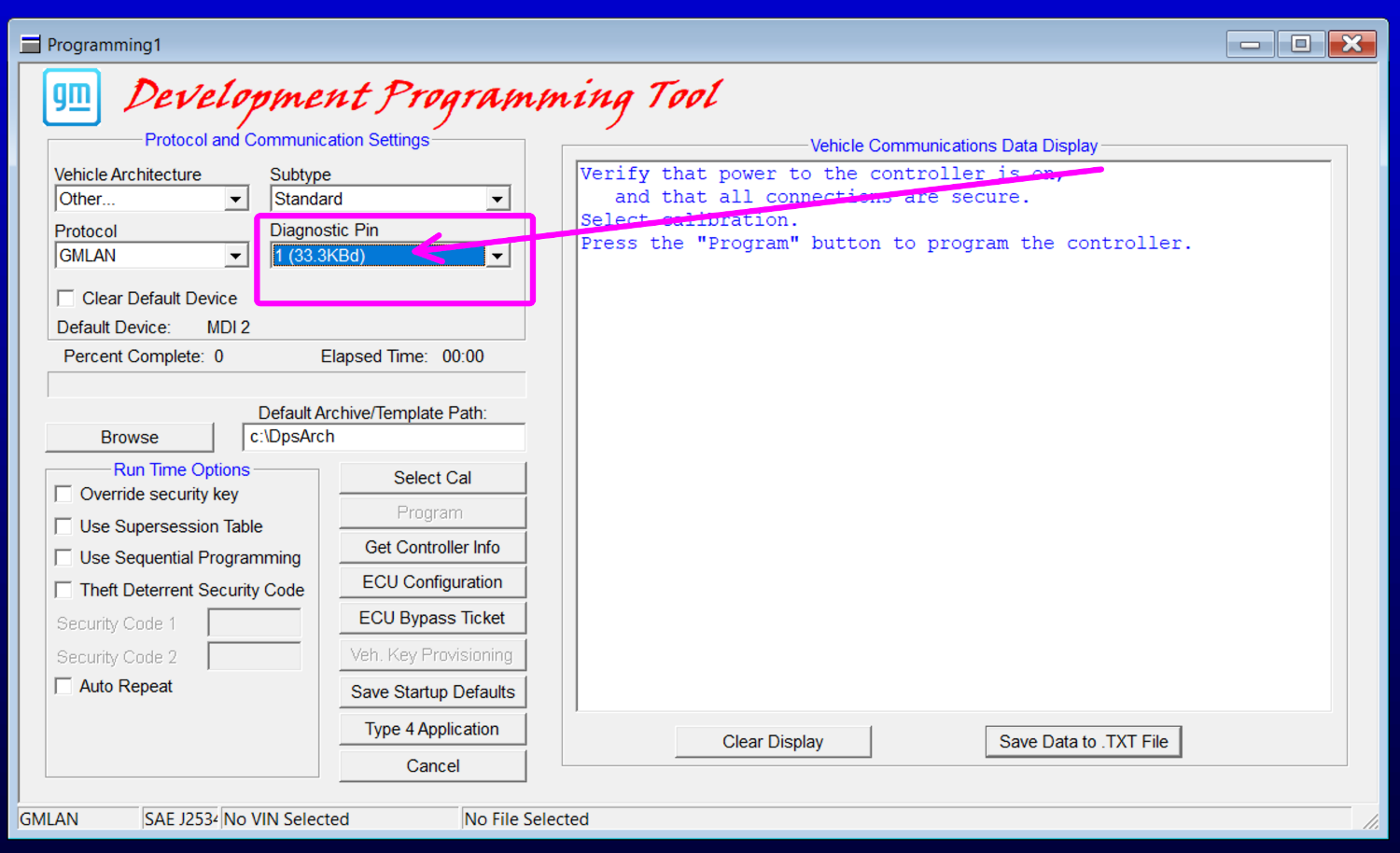

Your Log show High Speed can.
Are you using Pin 1 33.3?
Ipc are Low Speed Can
Yes that's correct Use PIN 1.
Set DPS diagnostic PIN to: PIN 1
Ok I’m trying with PIN 1. Is it ok to get in step03 value [0009] instead [0006] like is said in pdf manual?
