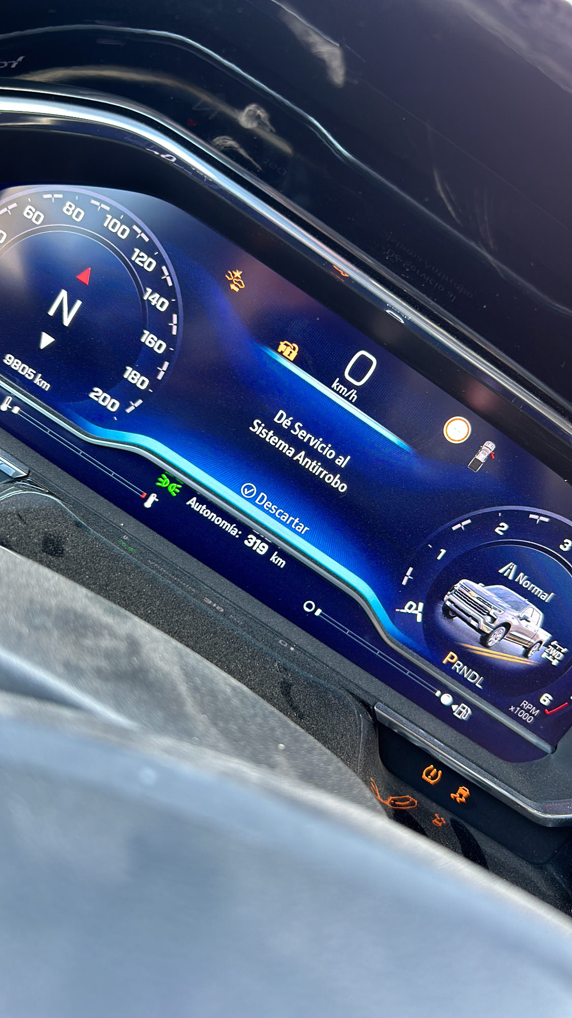

Hello friend I have a big problem with my 2023 Chevy truck, my truck has been stolen and a few months later I managed to recover it, when my truck was stolen I sent an alert through OnStar to deactivate it, but now my truck does not work, I already spoke to the OnStar company and deactivate the alert but I still have an immobilizer message,  I have even programmed 2 new keys with MDI2 OEM and I still have the same immobilizer problem, can you help me?

What is the exact IMMO error are you receiving?

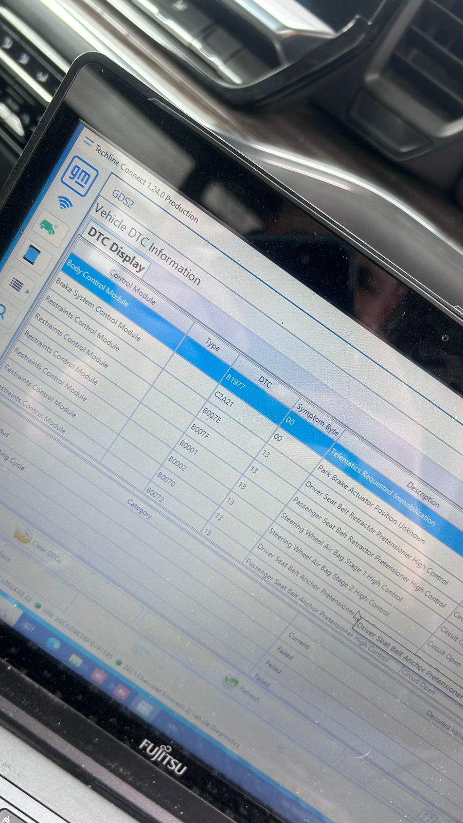

You have this DTC making A GDS2 Diagnostic?
B302A
 DTC B1977

        DTC B1977 is only an indicator that a start disable request has been received from the vehicle telematics system and does not indicate a fault in the immobilizer or telematics system.
        To remove the start disable request, the vehicle account must be updated with the OnStar stolen vehicle team. This will require that a law enforcement agency or the customer contact OnStar to indicate that the vehicle has been successfully and safely recovered.
        If the OnStar system has been disabled or damage during a theft attempt, the system will not be able to communicate and the start disable request will not be removed. OnStar must be functioning properly for the start disable request to be removed.

        Verify the OnStar system is not damaged and is operating properly, with no DTCs set.
            If the OnStar system is damaged, inoperative, or any OnStar DTCs are set
            These concerns must be corrected before the start disable can be removed.
            If the OnStar system is not damaged and is operating properly
        Press the blue OnStar button and ask the advisor to be transferred to the stolen vehicle team to verify the vehicle account has been updated.
        Verify that OnStar is aware the vehicle has been recovered and that the vehicle account has been updated.
            If OnStar has not been notified that the vehicle has been recovered
            Contact the customer and advise them that for security purposes, they must contact OnStar and the law enforcement agency to update the vehicle account.
            If the account has been properly updated
        Once the vehicle account has been updated and the start disable request has been removed, DTC B1977 will transition to a history DTC. Clear the history DTC.
