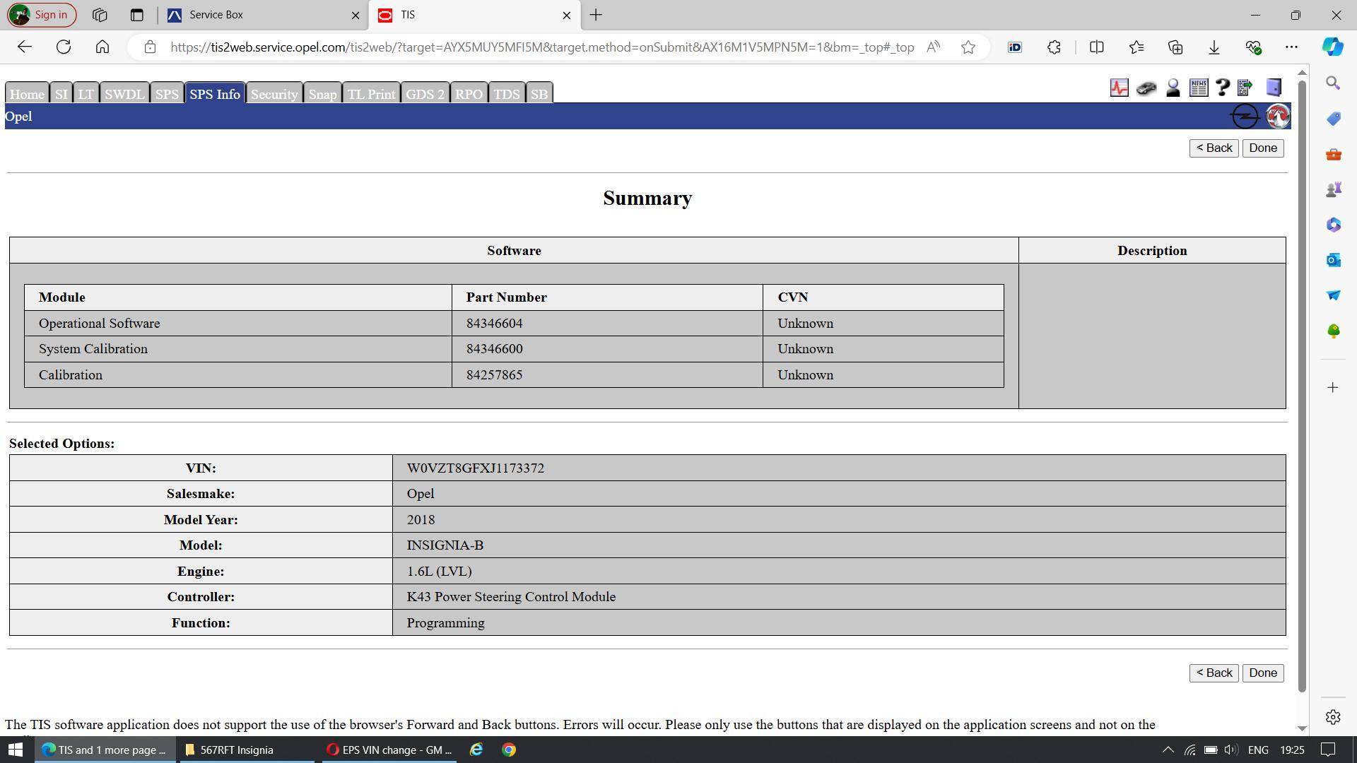

Hello. Also have a 2018 Insignia-B which has recond-hand steering rack (EPS) fitted  and now need to change the VIN. Seems like the seed is a 5 byte. Troy - do you have a file for 2018-2020 Insignia-B ?
Thank you
K43 Identification Information.pdf ProgramLog.Txt
use SPS to reprogram module then execute Setup&Configuration
HI. Cant SPS. Probably because there is wrong VIN in the EPS module, the SPS application gives error and does not recognise the module. I even tried to change the VIN manualy in the SPS application to the VIN that is stored in the EPS module but still gave error. Could not do programming nor Setup&Conf.
With the DPS I can read the EPS data and VIN but I dont have the EPS VIN Change program for 5 byte. And for Insignia-B I could not find it here either.

Hi, Where do I get the calibration files? Cant get them from SPS cache. Troy could you create a DPS file in general for Insignia-B and Astra-K EPS VIN change and put it up in the market for sell?
