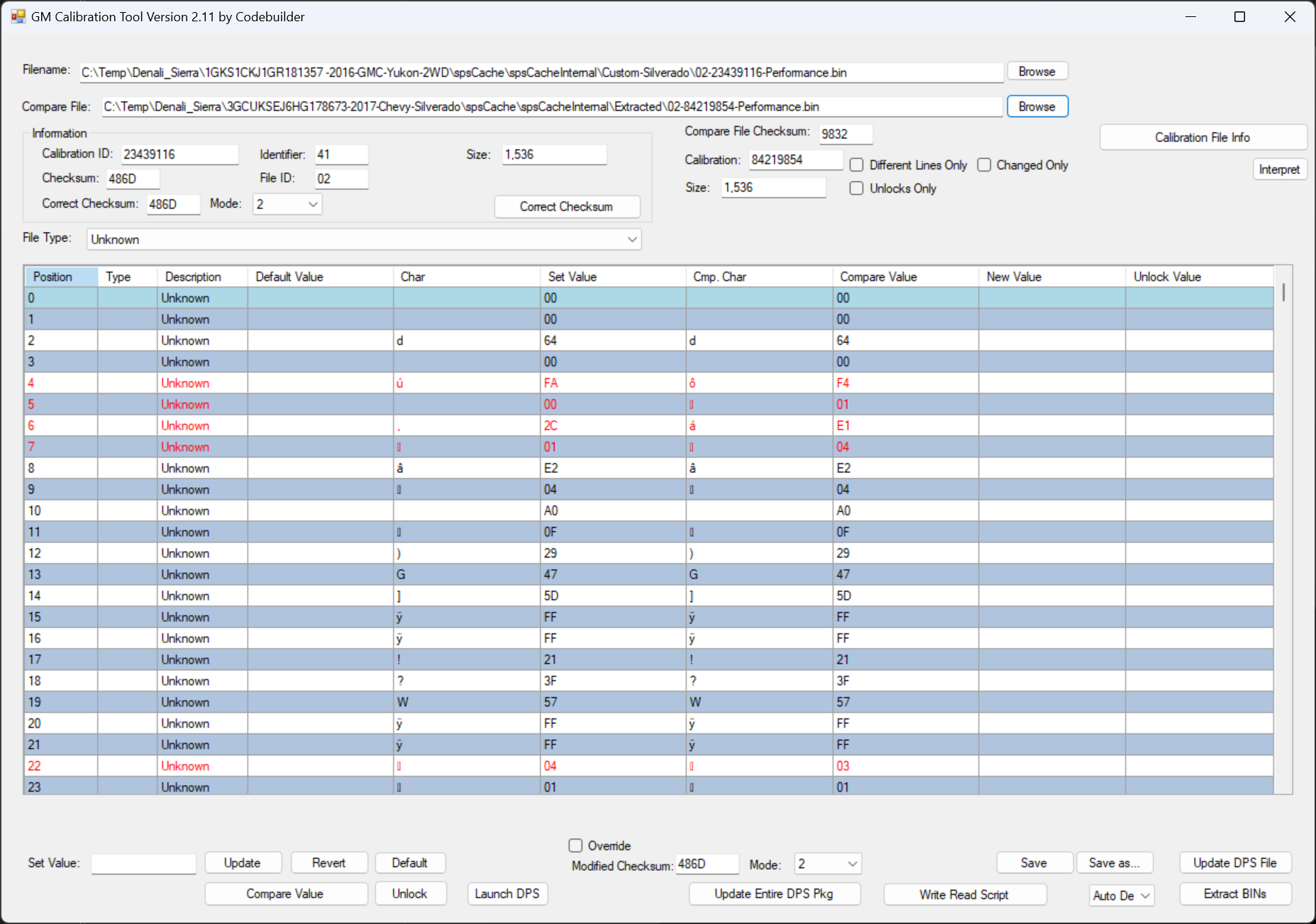

    Just reviewed the files, with your Sierra_programming_into_silverado.zip, are you trying to load ALL of your Silverado CALs and Sierra?  I looked at that and there's to many files.  That'll fail for s
  • The above vin 1GKS1CKJ1GR181357 is the not locked one that is currently in use in the pickup.
  • codebuilder
    codebuilder
    Yeah, you'll want to keep that cluster as a spare or toy lol....  You'll lose Android Auto / Carplay controls with it because it's a 2015 cluster.  I'll get the files though.

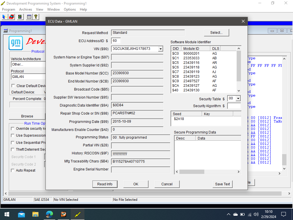

It really doesn't like the bootloader....  that's for sure the original VIN for that cluster?  Can you do a "get info" in DPS and get me all of the calibrations programmed into it?  ECU ID 60, low-speed bus as you've been doing but get me a screenshot if you can.    It should have taken that...  Especially as I'm using a VXDiag too.
here is a screenshot of the "get info".  I double checked to confirm the vin is the original one but not sure if somthing has been done to in previously as there is some odd info in the shop section.

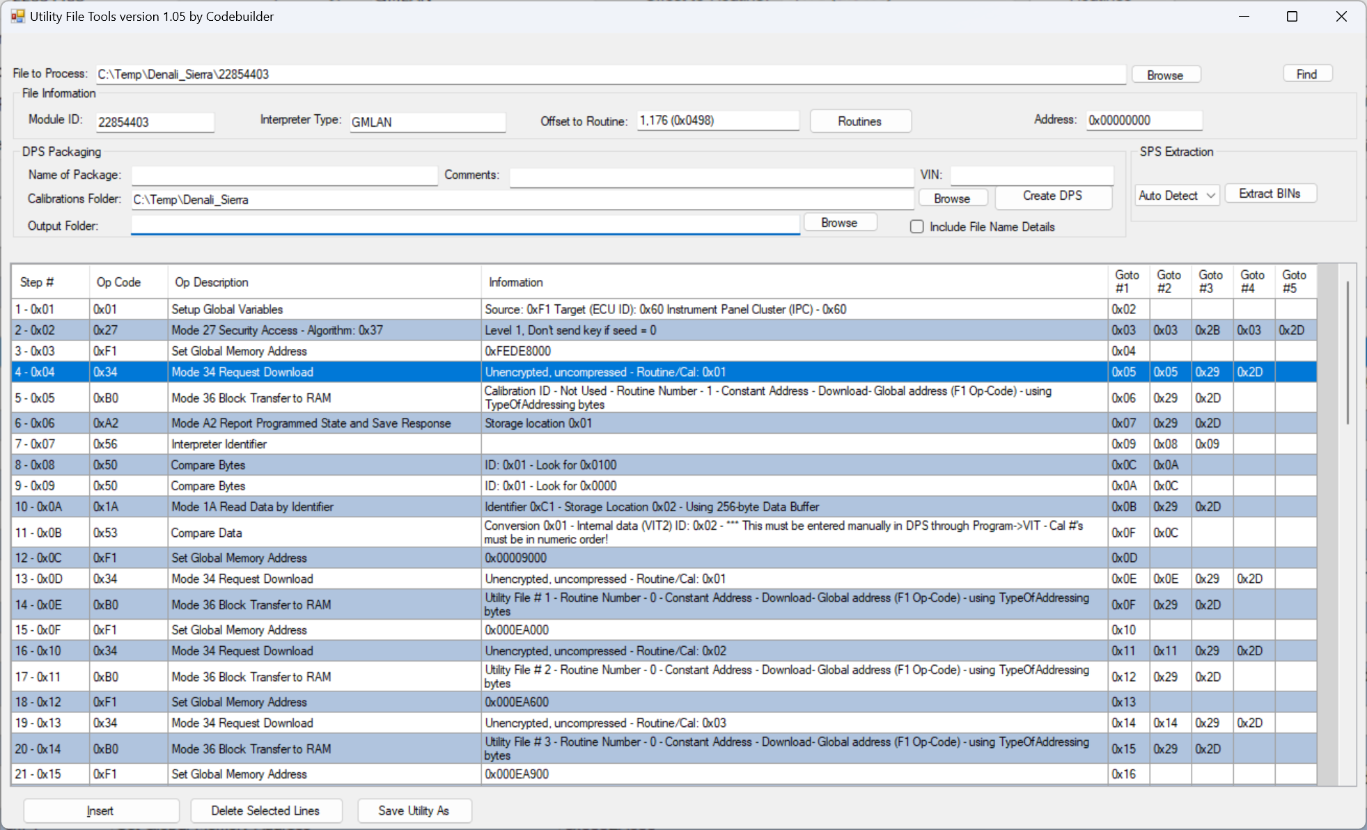

Preparing Controller
Utility File:  22854403.BIN
Utility File Step=01 Opcode=01
Utility File Step=02 Opcode=27
  21:06:04.306<[...L] 00 00 02 4C 27 01 [0006] FramePad
  21:06:04.306>[...L] 00 00 01 01 FE [0005] ExtAddress TxDone TxMsgType
  21:06:04.306>[...L] 00 00 02 4C [0004] TxDone TxMsgType
>> * Timeout Condition:  ECU DID NOT RESPOND - Invoke RETRY LOGIC! <-- It was expecting a 06 4C response from the module, it never got it...
  21:06:05.853<[...L] 00 00 02 4C 27 01 [0006] FramePad
  21:06:05.853>[...L] 00 00 02 4C [0004] TxDone TxMsgType
Utility File Step=03 Opcode=F1
Utility File Step=04 Opcode=34
  21:06:07.384<[...L] 00 00 02 4C 34 00 00 00 12 70 [0010] FramePad   <-- This should have never made it this far, that's what threw me off...  We never got security access....
  21:06:07.384>[...L] 00 00 02 4C [0004] TxDone TxMsgType

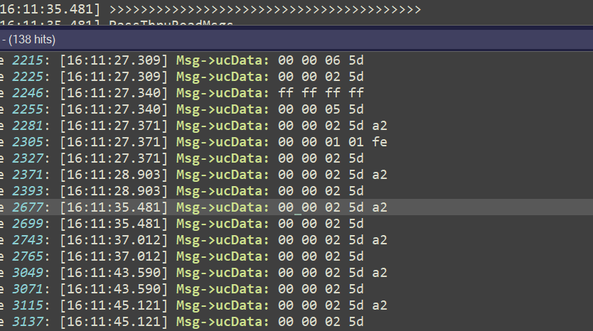

In the other log I can see it too:
Msg->ucData: 00 00 02 4c
    Line 2390: [21:06:05.853] Msg->ucData: 00 00 02 4c 27 01
    Line 2412: [21:06:05.853] Msg->ucData: 00 00 02 4c
    Line 2443: [21:06:07.384] Msg->ucData: 00 00 02 4c 34 00 00 00 12 70
    Line 2465: [21:06:07.384] Msg->ucData: 00 00 02 4c
    Line 2509: [21:06:08.916] Msg->ucData: 00 00 02 4c 34 00 00 00 12 70
    Line 2531: [21:06:08.916] Msg->ucData: 00 00 02 4c
    Line 2617: [21:06:11.568] Msg->ucData: 00 00 02 4c 34 00 00 00 12 70
    Line 2639: [21:06:11.568] Msg->ucData: 00 00 02 4c
    Line 2683: [21:06:13.099] Msg->ucData: 00 00 02 4c 34 00 00 00 12 70
    Line 2705: [21:06:13.099] Msg->ucData: 00 00 02 4c
    Line 2791: [21:06:15.738] Msg->ucData: 00 00 02 4c 34 00 00 00 12 70
    Line 2813: [21:06:15.738] Msg->ucData: 00 00 02 4c
    Line 2857: [21:06:17.269] Msg->ucData: 00 00 02 4c 34 00 00 00 12 70
Your VCX is requesting commands to the cluster but it never responds back!
I'm heavily leaning it's your driver.
For fun, could you do a "Get Info" then get me that VCX log?  I just want to see if it sets up filters.  Your VCX is definitely working or you wouldn't be able to do that.  Right now, I suspect it's when it tries to setup the flow control filters.
