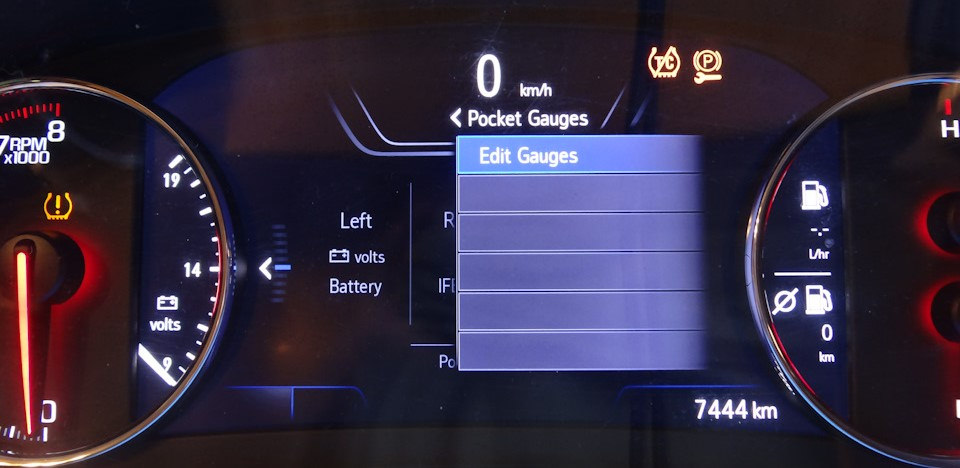

8-inch IPC "pocket gauges" enable?
Does anyone know the parameter to enable the "pocket gauges" on the Insignia B 8-inch IPC?
I have tried and not managed to work it out.

  • The pocket gauges menu, only appears in UHS Info3.   In the older UHS, for HMI, this menu not exists. then, it cant be enabled.   In UHS Info3, depends of calibrations from the IPC
just change theme with XML file?
Do you still have a same problem? I might be able to have a look at this for you. Assuming it is commodore ZB based in your country?
