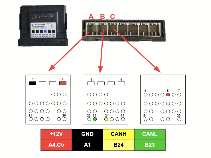

is possible program the bcm on bench with dps?? if it is possible wichc is pinout?? i try using pinout from ioterminal but not conect to the bcm.

Hi,
if you want to connect to BCM on bench with MDI2 or similar, you have to add 120 Ohms resistance between CANH and CANL.
I had the same...
Greetings,
Toby
