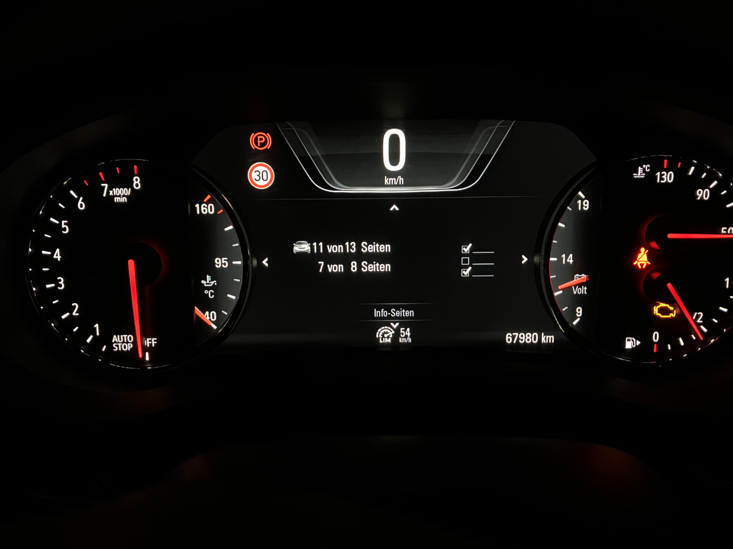

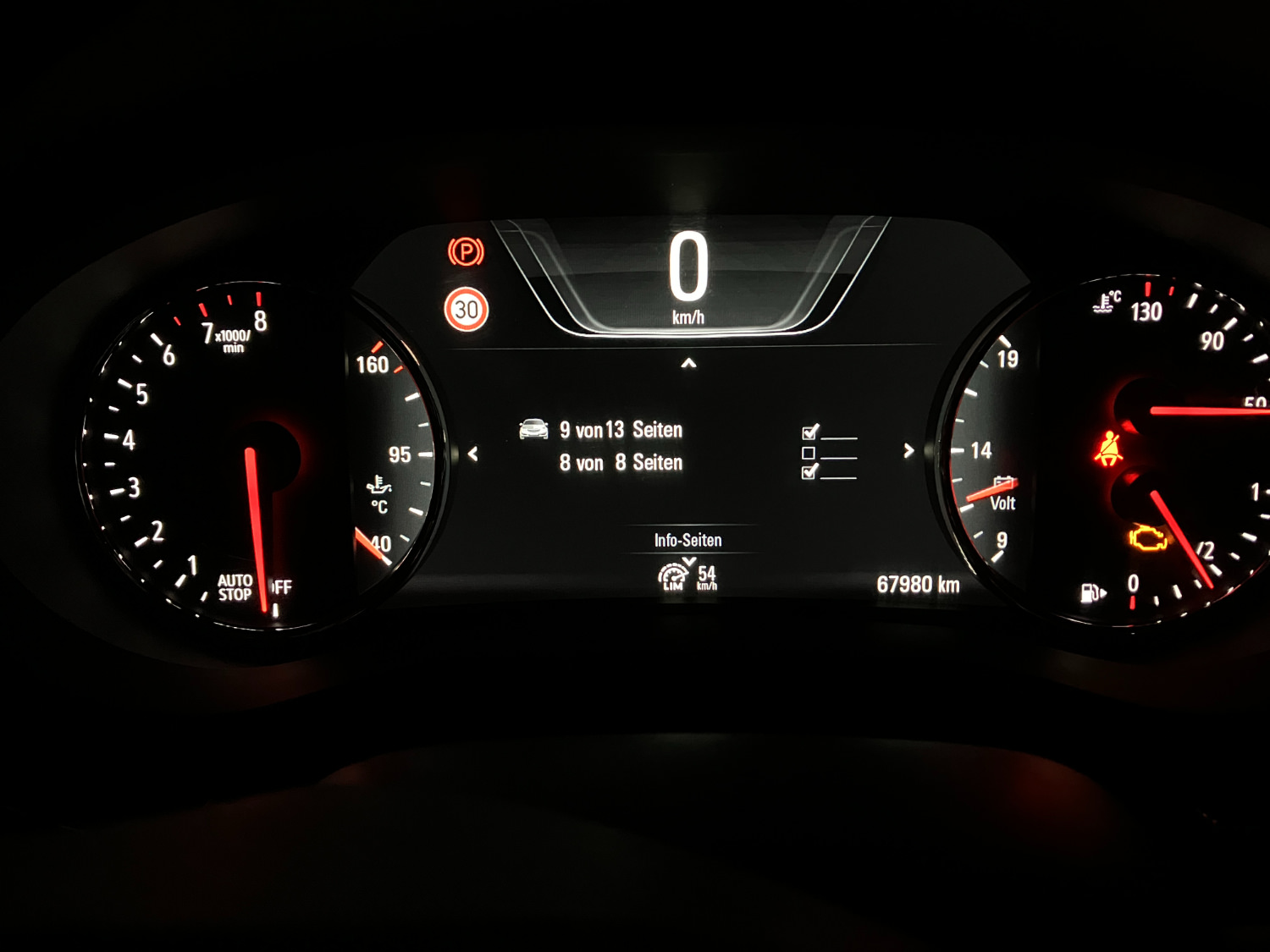

Before: 9 out of 14 Pages.
After reset: 14 out of 14 Pages.

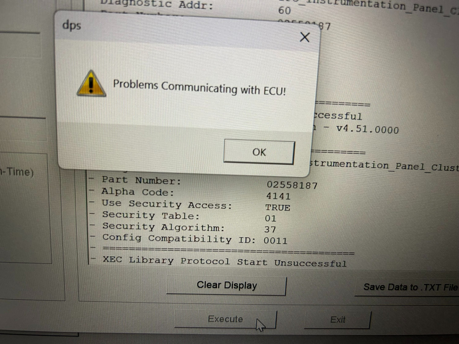

XMLFile.xml Run it in DPS and look in the log file for the raw data.
