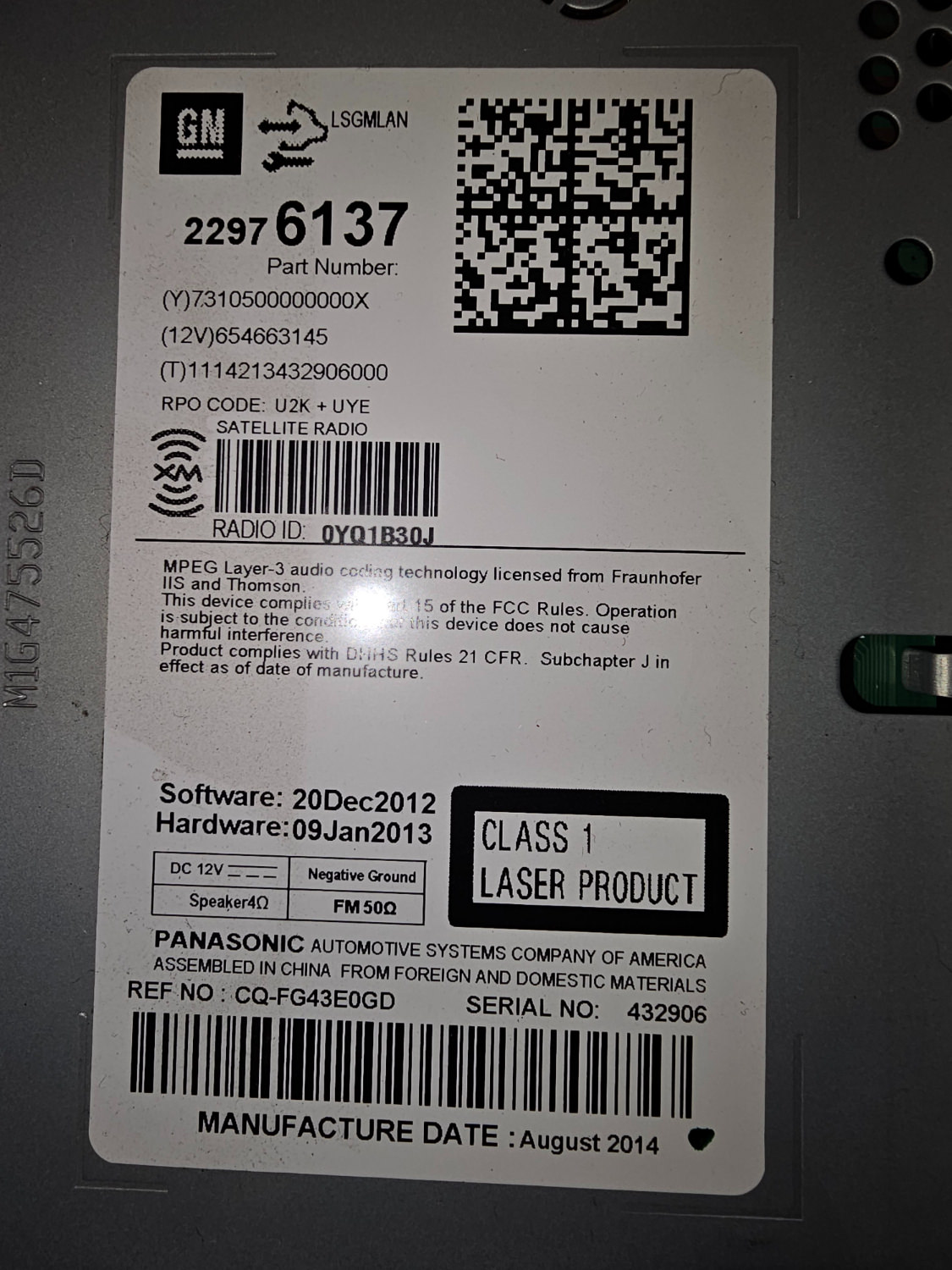

Hi, can you post photos of the radio showing the label stickers and the connection ports?

Thank you for your time. I am unsure of whether there is an hmi module. only have radios.
