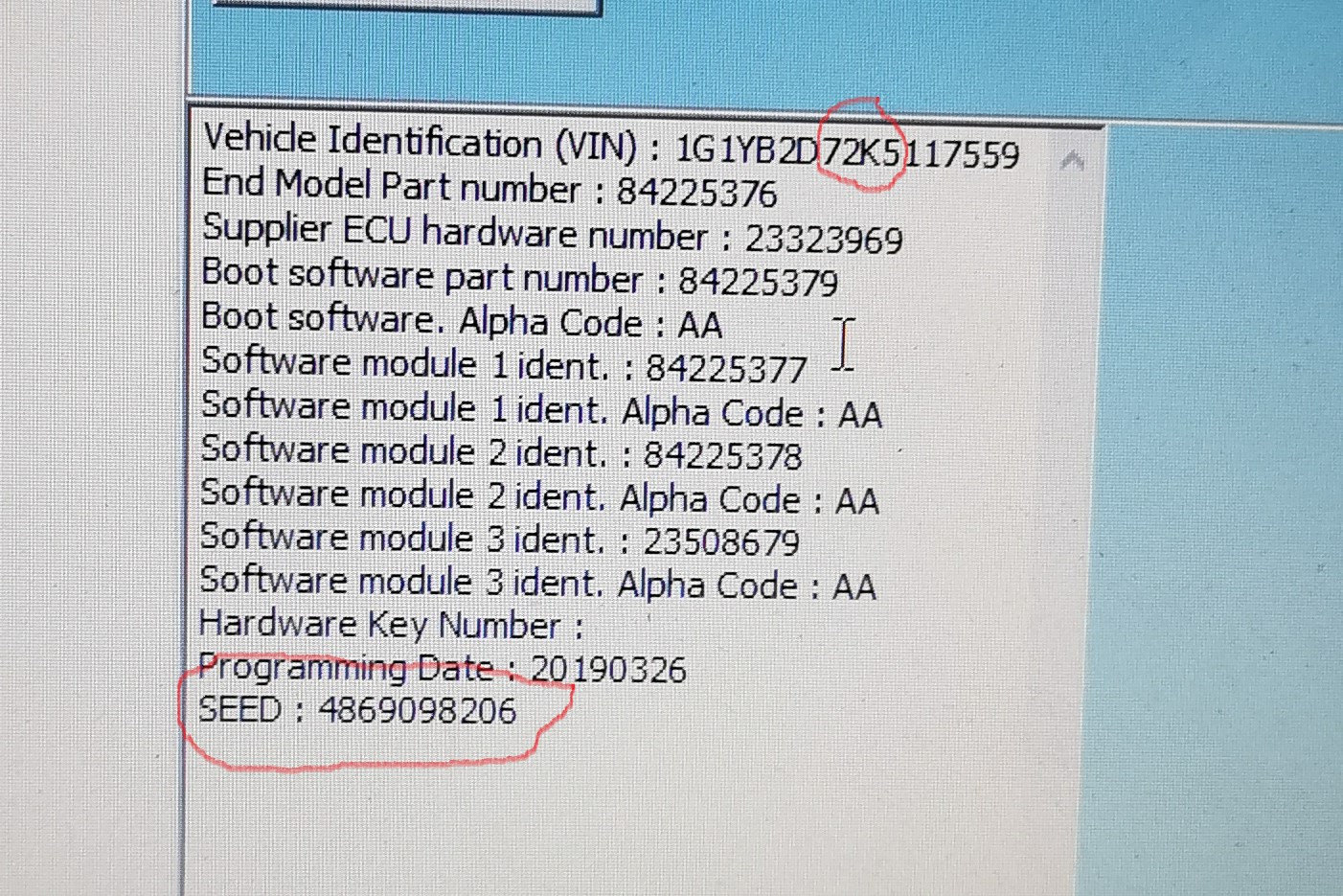

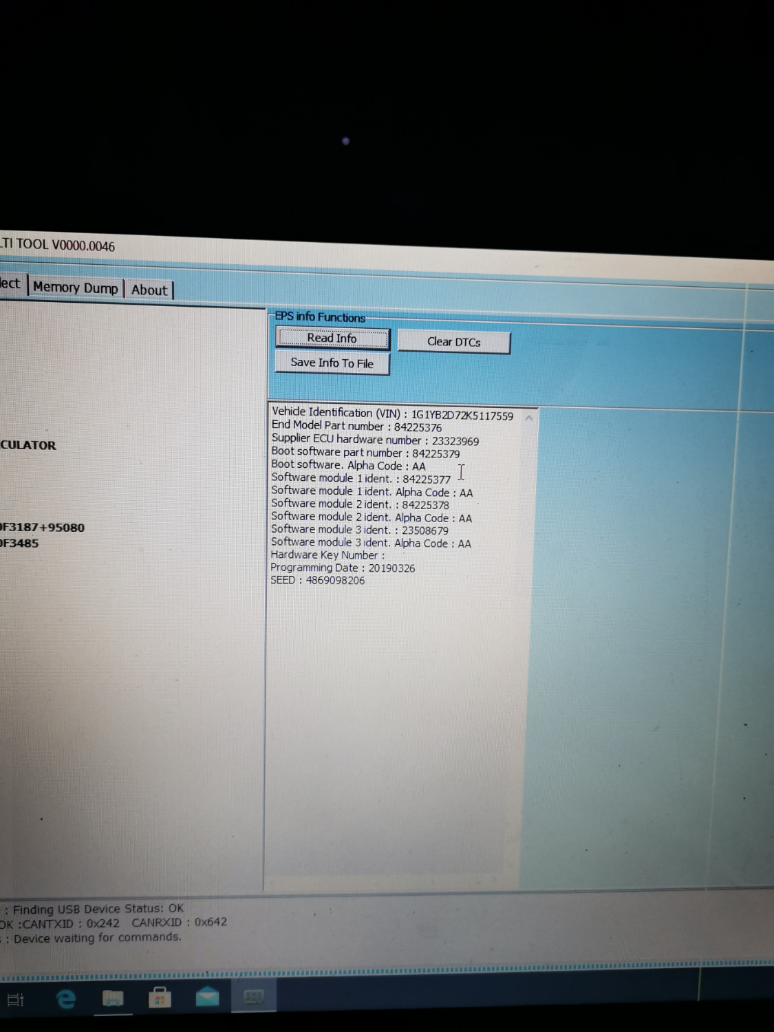

 Guys, look on the picture, this is read info from IP Terminal from EPS module, end the seed is 5 byte, another thing is that this EPS is not from 2014 but from 2019 , that why i bough  this file. Today I checked that i Can make Read Info from Low Speed CAN , but I can not  read info from High Speed CAN ( only by DPS in this car  , GDS2 works with all speeds).

I think is because DPS receive wrong answer from EPS as been used in newer platform Vehicle.

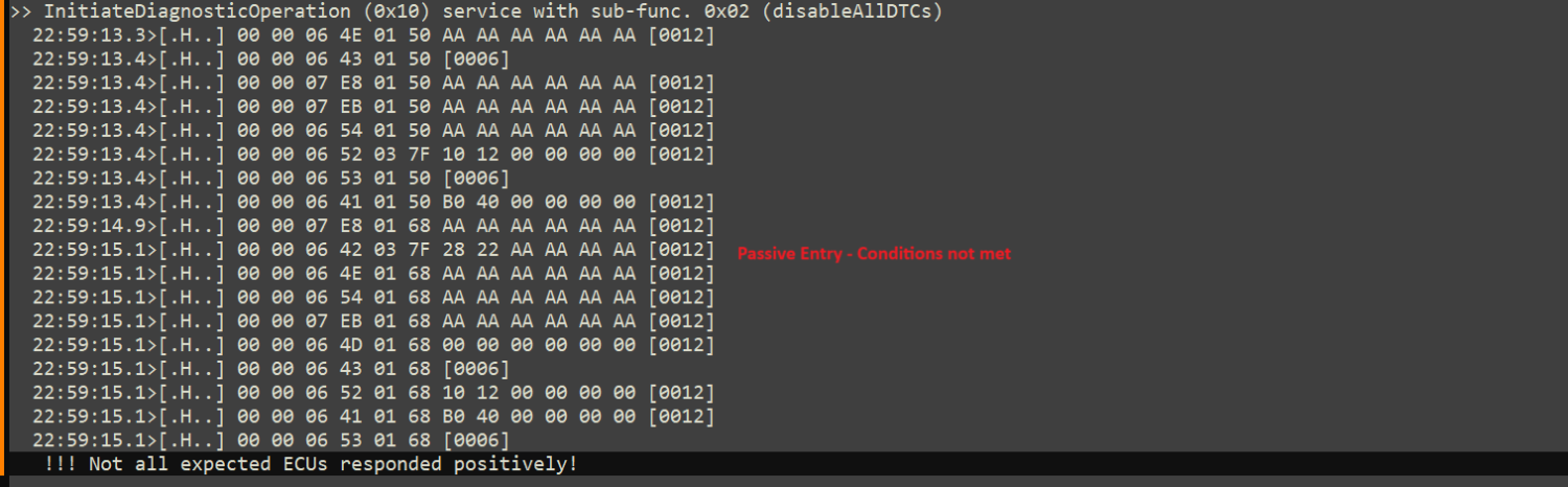

I don't know when you did this log but you didn't get far enough yet to be anything else.  You wouldn't have been able to program any module on that bus.  I don't know if you didn't cycle the key between tries but you had one computer still unhappy.  I would cycle the key, try it again and see if it gets further than that.  I'm convinced like Lyobmir said, it's probably a mismatch but this log is telling me you didn't even get far enough for SPS to even ask what the current calibrations are.  In fact, you didn't even get far enough for it to even think about programming it.  Basically, I'm just saying that log file doesn't provide enough.  Can you turn the key off, reset everything, try it again and see if you get more detail?  It's like you've tried it twice and it left it in an errored state through that session.  Does that make sense?

I've looked at the log in more detail, I can tell the engine was off otherwise I'd expect the BCM and others to fail too.  If this is what's continually reporting conditions not met, you need to either find out why this module is reporting that, unplug it and try without (if you can) or try it on a bench.

Ugh, and I put the wrong module.  642/242 is actually your EPS.  You put it into a state that made it report conditions not met in the log you gave us.  I'm guessing that wasn't your first attempt.  Power cycle it, then try to program it and upload that log.  Again though, I'm thinking Lyubomir but the log you posted is misleading us.
