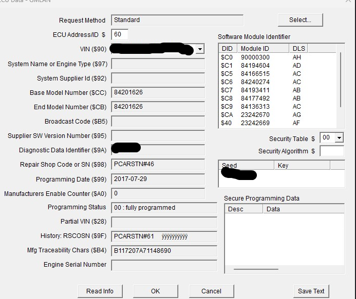

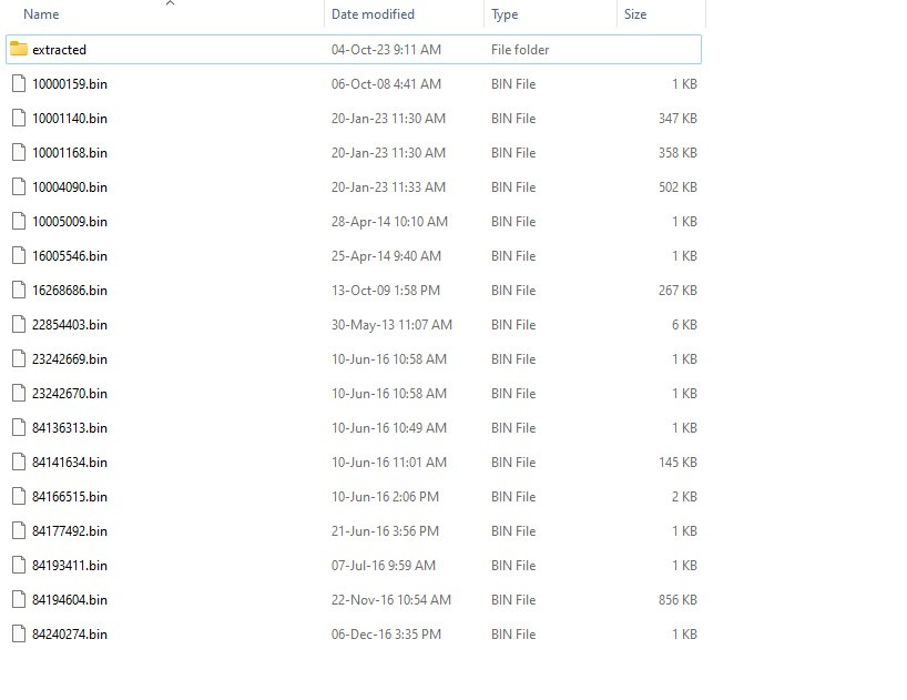

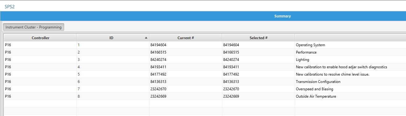

I am trying to reprogram VIN and XML files for a replacement upgraded cluster. When trying to download the calibration files, SPS downloads 17 files but the cluster is supposed to have like 9.
Also, DPS is telling me the cluster has 11 calibrations. Which is confusing.

    Cleanup folder and execute programming again to download only current files. And looking your download folder these files is not downloaded in same time. Or check correct log for which files u need to
    then make it dps package and flash it 🙂 it should be 8 match numbers from sps and 9th is utility file. Then will need to execute Setup ofcourse
Cleanup folder and execute programming again to download only current files. And looking your download folder these files is not downloaded in same time. Or check correct log for which files u need to use. If sps say 8 files, u have to get 9 downloaded which 9th is utility file.
I noticed it stored 9 calibration files in the spsDebug, instead the regular spsCacheInternal.
