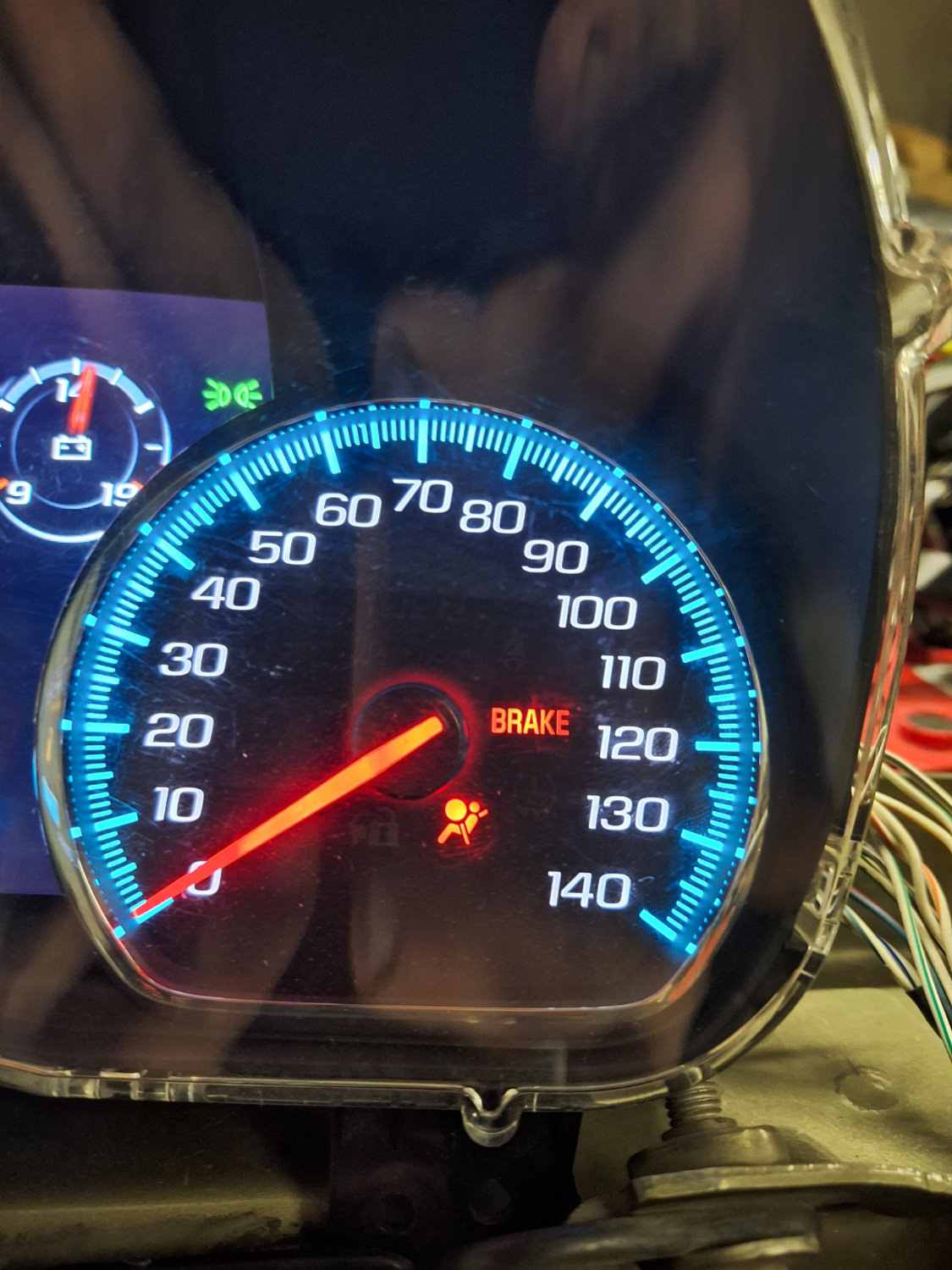

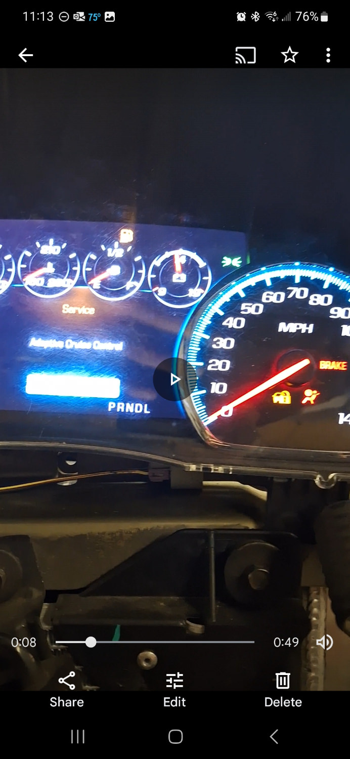

Hello to all. I have a 2017 6.2 engine, 8l90 transmission and a 2018 Yukon digital screen cluster all going into a 2006 hummer. I have disable tons of the warnings in the cluster that are not going to be used. For instance i have disable the theft lock light and service theft warning that scrolls the cluster. Has anyone done anything similar? I have ABS, Traction control airbag light, service adaptive cruise and service safety restraint system left that I can't seem to find in the xml file. Any ideas?

  • I wish I had some document that said what each position does, but I'm afraid there is nothing, and only GM knows that. The only way to guess something is to compare calibrations of different cars
For disable the ACC you can load the calibrations of the same speedometer without ACC. Or edit the calibrations of this IPC (cal number 4 position hex 18 to 0 (and correct checksum))
Which calibration file are you referring to.  I'm still new at this.

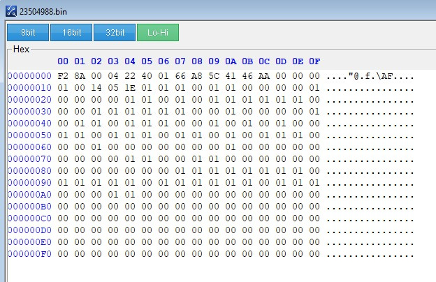

Hi, where can I see a list of the positions for the indicator calibration file, so I can know what to enable or disable? Here is an example.
