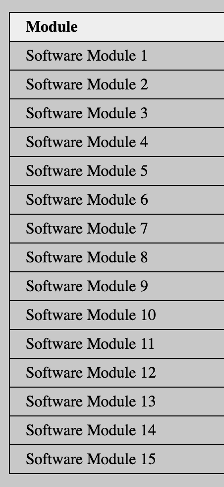

On the Tis website, it states 15 calibrations for the radio module. Do you know which number is for the tuner calibration?

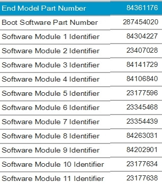

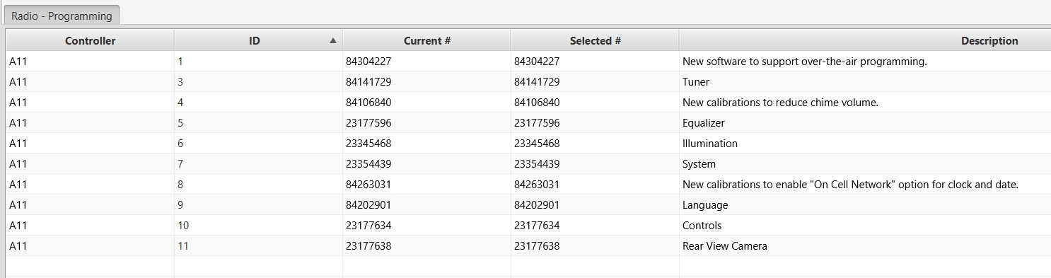

Hi,
There only seems to be 11 software module identifiers showing on GDS2. Tuner is software module 3.
