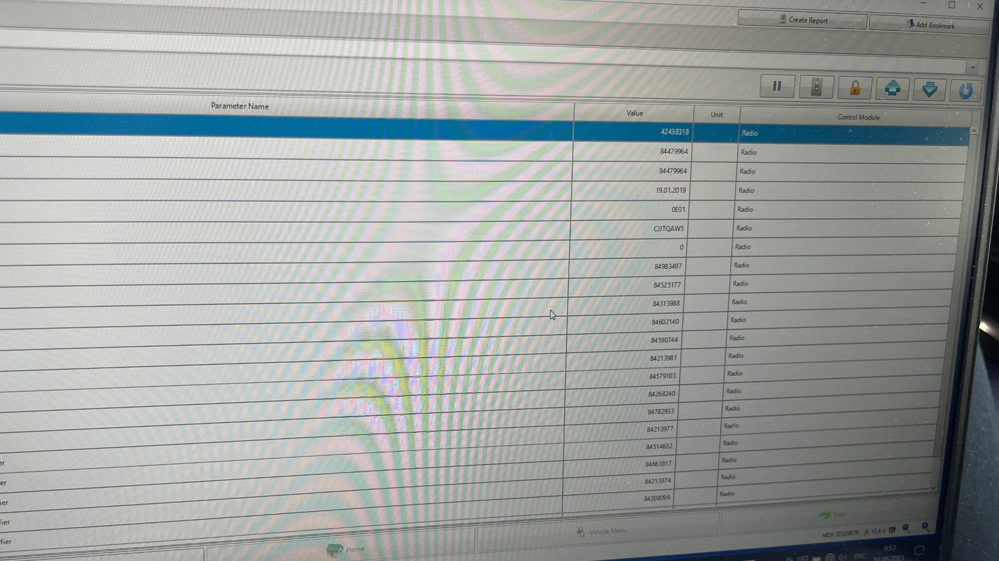

I flashed IOR software. Having an LT complectation of car. At first one 1G1ZD5ST2KF165847. Need to add step for am/fm and additional languages...

Hi. There is mine identification data. Can you please help? I searched all forums for help..

I already been on other calibration, but update changed it.
It was: 84479964 and 84595707. This two differences
