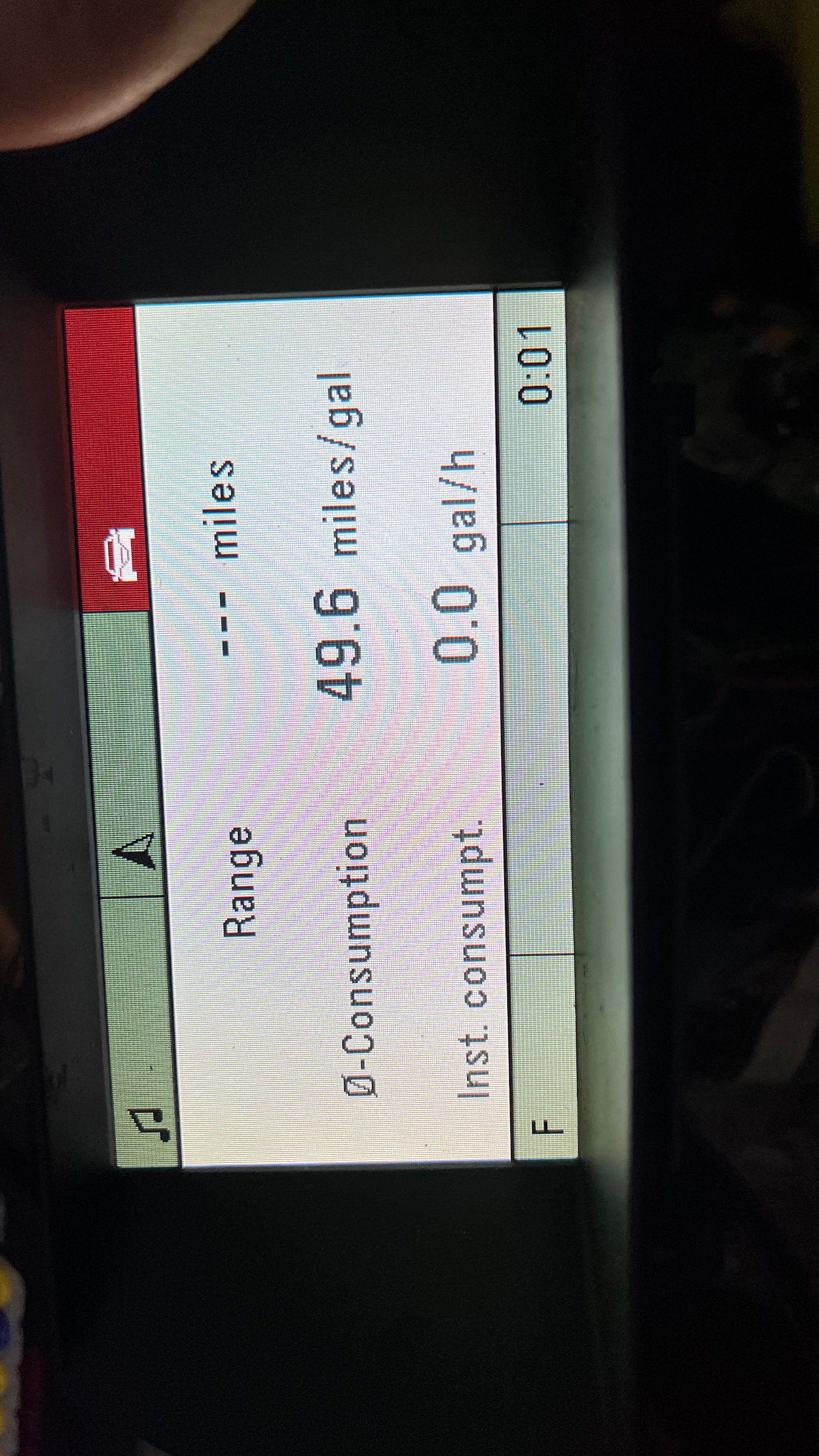

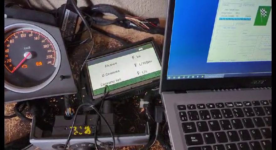

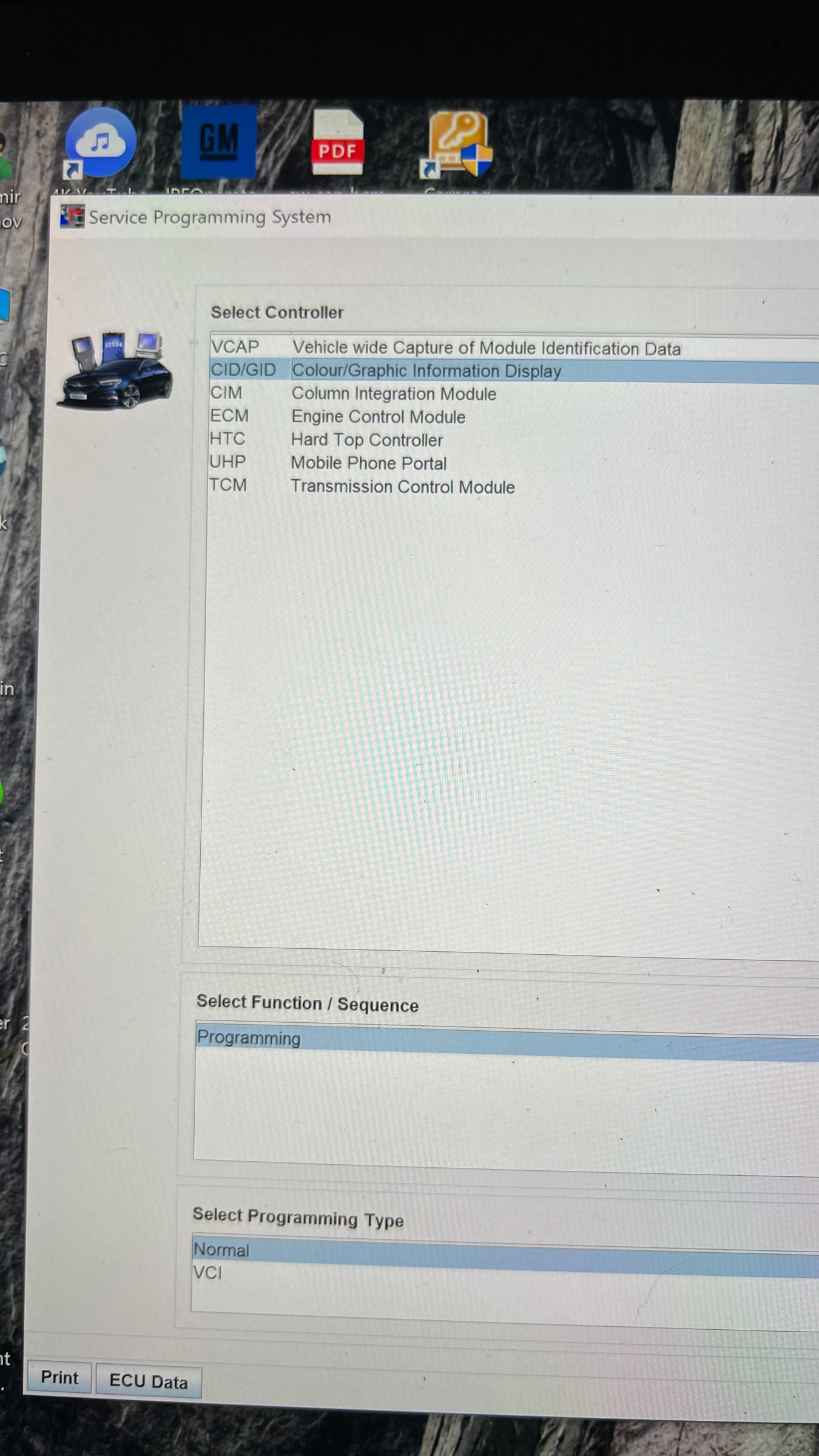

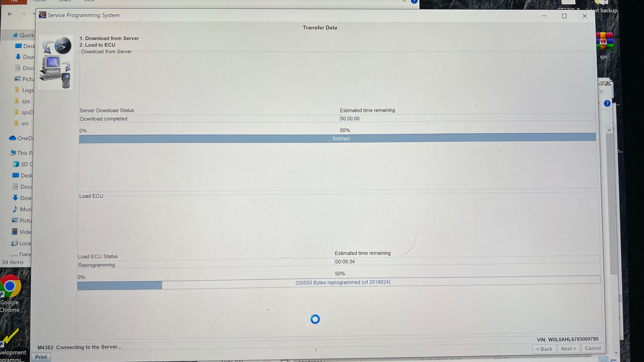

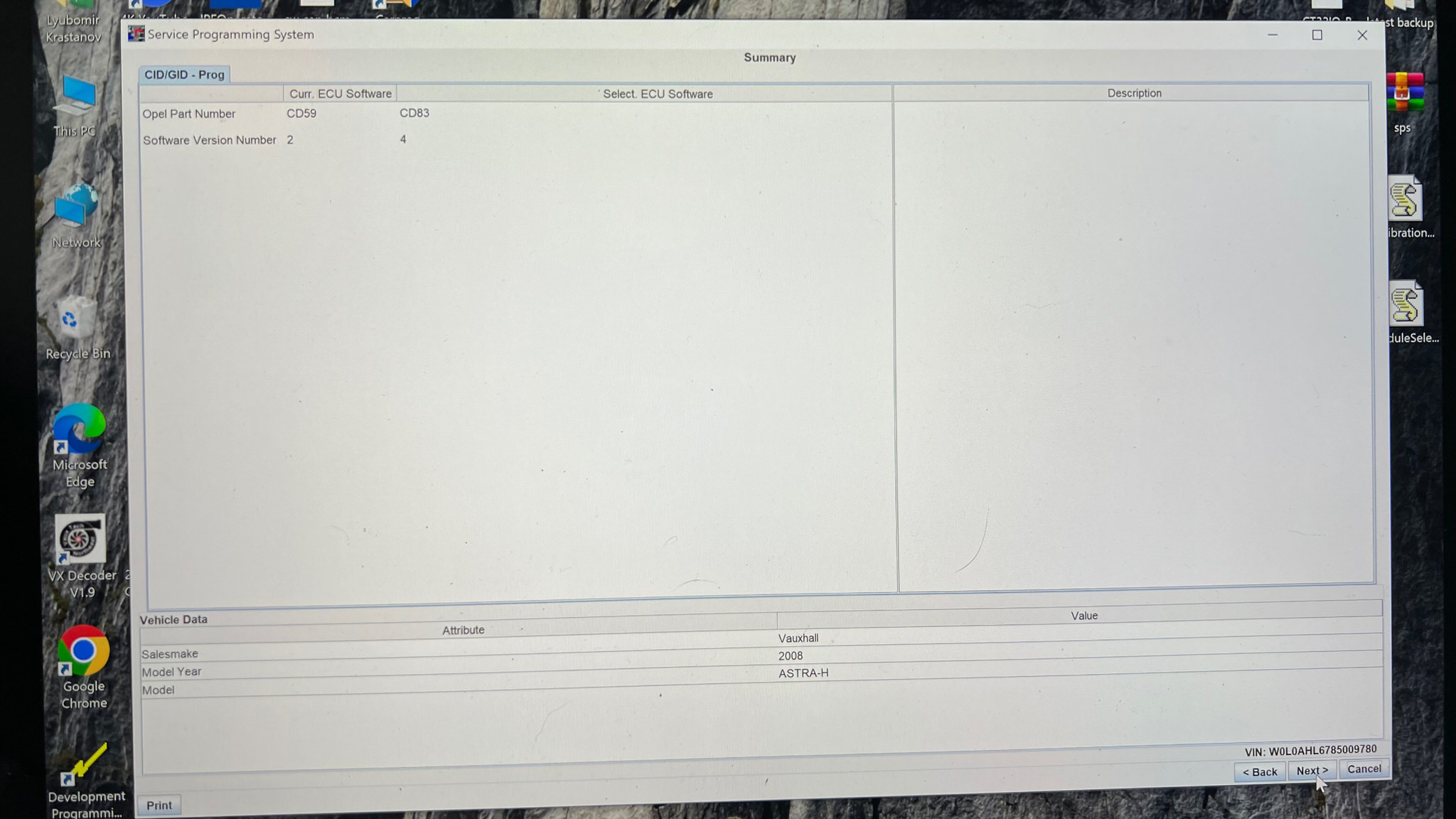

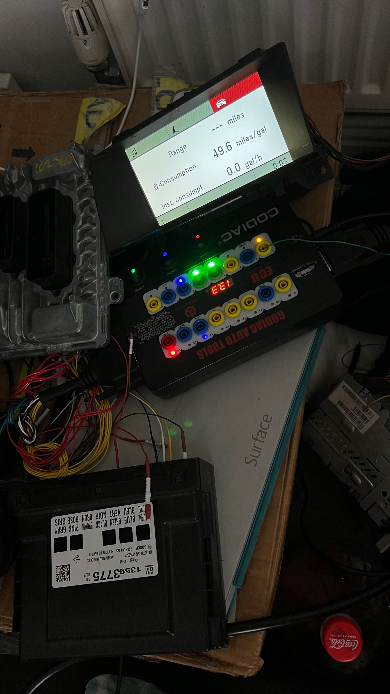

Thanks to @Troy mentioned GoDiag tool. Now finally been possible to make it without vehicle. IMG_1800.thumb.jpeg.1425c7be2f26bf07ef04f7210ff936cf.jpegIMG_1801.thumb.jpeg.542c0709dc0a420d50304e72ec4a0f0a.jpegIMG_1803.thumb.jpeg.88ad293bdc49e1dcf255e01ec4592d44.jpegIMG_1809.thumb.jpeg.372af9c3c881702cac4db98fdfb6e9c0.jpegIMG_1808.thumb.jpeg.1802a32ef7a6a3b6302f0946fc6b72cc.jpeg

  • Now that I see this thread.   There are two methods to update. Modify the eeprom, and make SPS believe that it is a BN cid to update. Or capture the SPS cache files and make a package for D
There are two methods to update. Modify the eeprom, and make SPS believe that it is a BN cid to update. Or capture the SPS cache files and make a package for DPS. The second works perfectly, I have already updated several without having to modify the CID eeprom using DPS and the update pack
