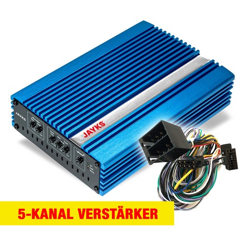

 1 year ago i've upgraded my opel insignia with an isotec 5d amplifier:
WWW.EBAY.IT
Le migliori offerte per ISO-5D Amplificatore/Amplificatore per Opel Insignia A - 08-06/13 / Plug&Play sono su eBay ✓ Confronta prezzi e caratteristiche di prodotti nuovi e usati ✓...
basically i have the issues with high frequency and sound system alert (while parking for example) that sound is so f***ed up.
In the product description seller talks about a vin unlock for the original amplifier in order to unlock it. This is the translation:
Re-programming on sound system: • In principle, any Plug & Play amplifier can be used with or without sound system reprogramming. However, reprogramming to the sound system may be necessary, e.g. if the volume of the service/navigation tones is disruptive and/or the frequency response is not linear. In such a case, in the The VCI code for the relevant vehicle can be requested from an Opel specialist workshop. • The VCI request "Sound system retrofitted" is sent to Opel in Rüsselsheim, together with the Vehicle Identification Number (VIN) • The individual VCI code then activates the sound system by entering it in the OBD tester Reprogramming to sound system leads to the following results: 1. Linear frequency response - bass and treble are no longer overemphasized 2. stronger bass response 3. Unlocking the preamp outputs 4. Reduction of the volume level for service tones and navigation announcements--
Called 3 opel dealears around me and no one was willing to do that, they don't want to assume any "risk" even if i am willing to pay good money for it.
Could someone give me some hints? I'm sure here's the right place for that kind of support!
