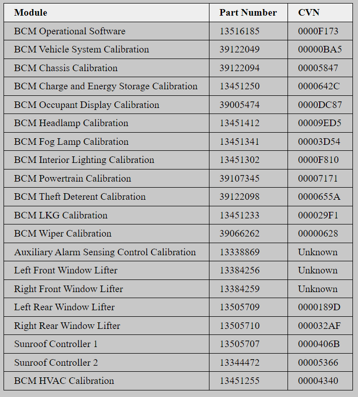

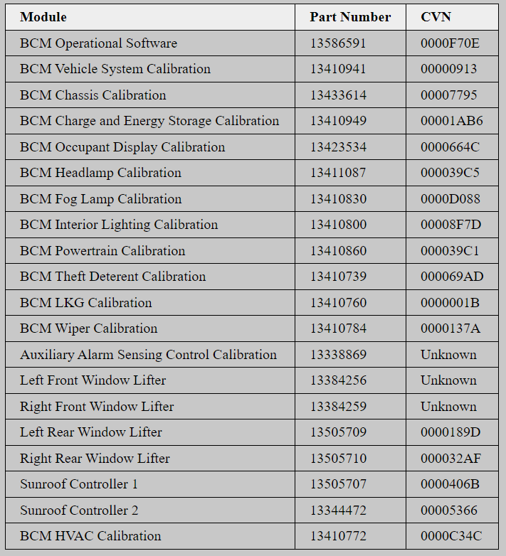

Hi Guys,
Does anyone have Astra J BCM files to activate the Sport button? (RPO UJC)
Current files for vehicle are (2013 Model)
A newer (2017) Astra J GTC with sport button is here but most files are changed

    if you want sport button, the best way is looking a vin of the same year, engine... with sport and uses their calibrations in the BCM, or replace only the necesary calibration for sport (this is bette

if you want sport button, the best way is looking a vin of the same year, engine... with sport and uses their calibrations in the BCM, or replace only the necesary calibration for sport (this is better way)
I think is the powertrain calibration
It certainly is... I added it to mine a couple of weeks ago but wired through the eco button so sport is switched on when eco is switched off..
