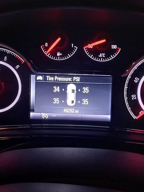

3 minutes ago, WSOpel said:
TPMS Active

I'll give the cluster a try later this evening and let you know.... thanks again 😉

Front fogs now programmed with your cals and working perfectly 🙂... Thanks again for the time and effort you've put into helping me get there...👍

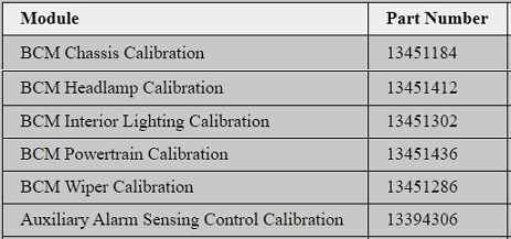

If anyone has a bcm calibration set for vin W0LPF2ES6EG057626 those would help a lot with my next project.. most of the files are already in the archive above very kindly posted by @WSOpel , the files which differ slightly are below.... Many thanks
