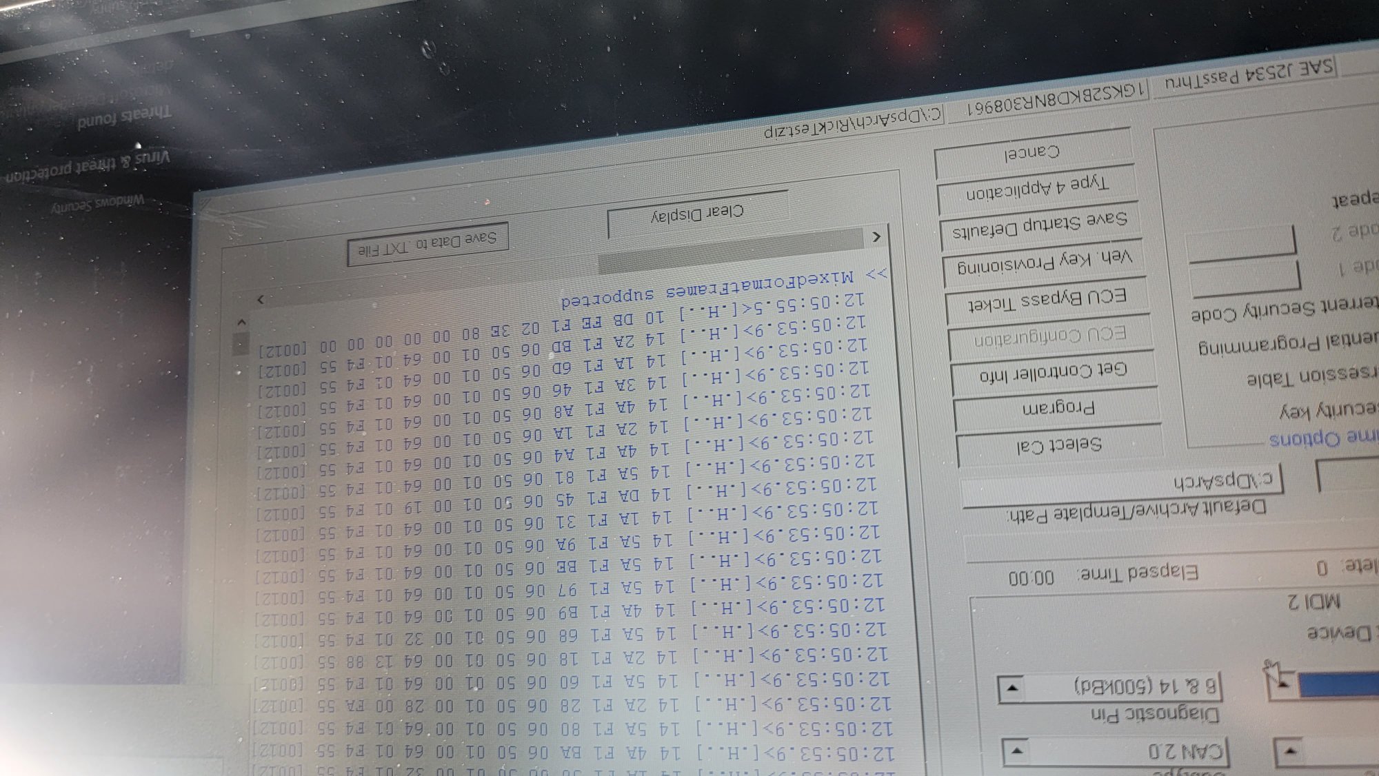

Hello Guys,
I am getting an error on programming the IPC on a 2022 GMC Yukon. I get MixedFormatFrames dupported. I have built the archive 2 times. I noticed that when extracting the calibration files, I get files with no file extension except for the "~" character. I have added the .bin extensions and still a no go. I have attached a picture of the error as well as the log file.
Thanks,
Speedo32

The GM Global-B vehicles uses a much newer higher secured architecture and cannot be programmed with DPS as easy as the Global-A vehicles. You need to generate the Global-B Key externally, or have access to a legit DPS account. The cracked DPS won't work with Global-B vehicles.

23 hours ago, achilles said:
This error is because you have turned on the ACC power mode, please turn it off, the meter remains off, the can b programming needs to turn off the car power,
Didn't I already help you out with the programming of the can b module?
Yes, thank you achilles. What he says above is correct, all modules need to be off in order for programming to work.
Thanks for the help Achiles was correct and very helpful.
