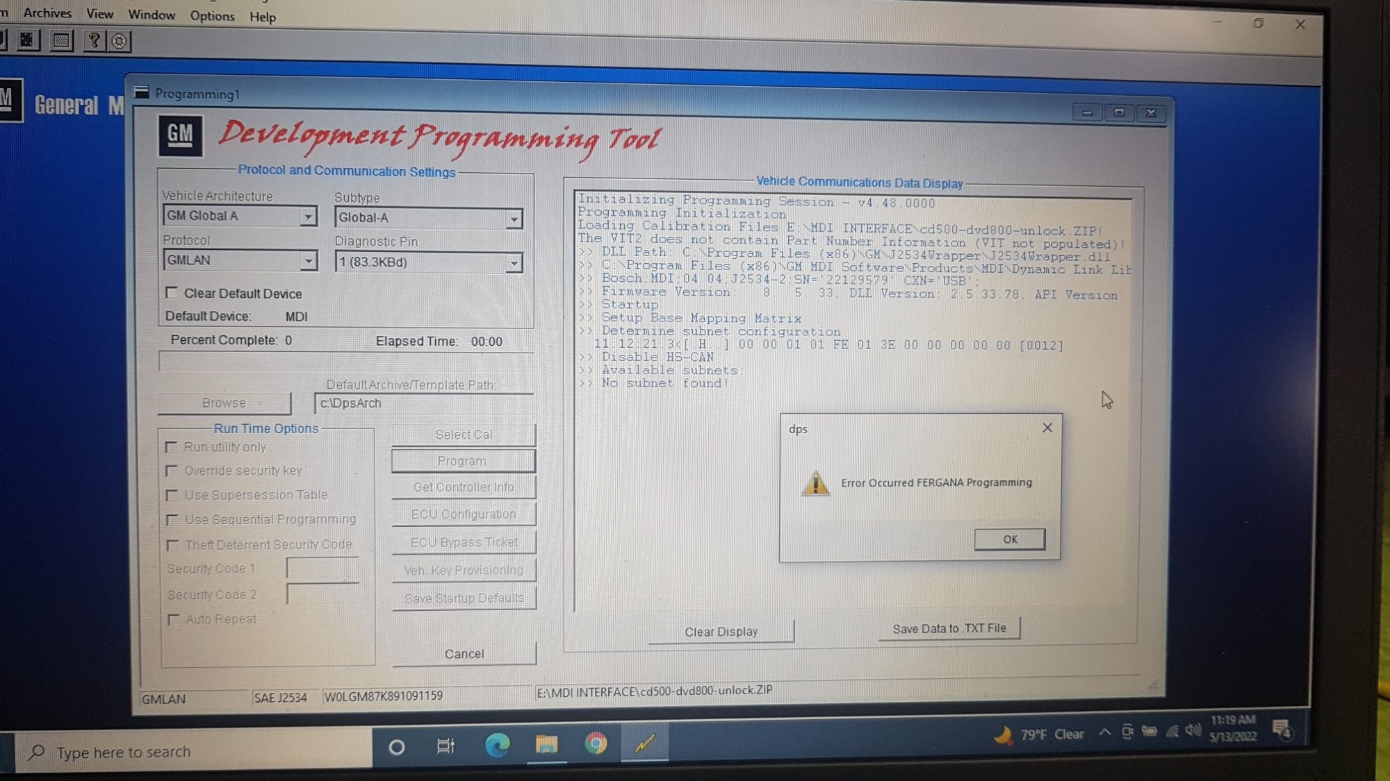

i use MDI interface  and have comunication with car , read info working but when tray programing CAL file not pass.
Is it need some adjust is DPS tool before programing ?
is it ok procedure step by step :
1. vehicle architecture = GM global A
2. sybtype = golbal A
3. Protocol = gmlan
4. diagnostic pin = 1. 83.3kb
5. get controler info / select MDI interface
6. ecu adres ID = 11  ???   or need change
7. request method = standard  ? or need change
8. read info and ok
9. selec calibration zip file and load
10. program
Then i have error ...

Maybe your interface is the issue. You may need to buy a VXdiag nano GM interface, that one works great with DPS.
Strange , i use original MDI interface which working on last gds2 perfect , win tech2 on win 10 all working .
Which version DPS prefer  ?
I bay allso and last 4.8 version and will tray.

Use dps 4.46 that one works fine.

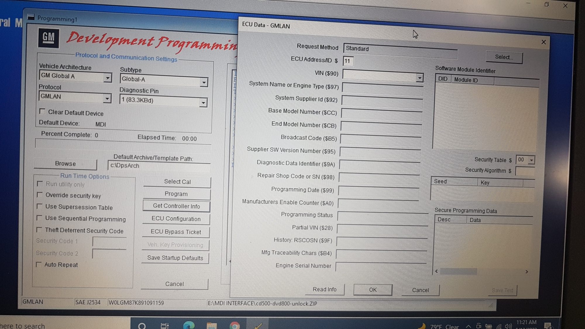

Its not need  some adjust  in controler info tab  for insignia 2009
ECU adres ID / 11 is set
request metod / standard
Also not need to write first  VIN in BCM like HMI modul ?
In protocol and comunication seting  is ok to be select  :
1. vehicle architecture = GM global A    or    Other
2. sybtype = golbal A    or   Standard
3. Protocol = gmlan
Then load  unlock zip file and program unit  ?
