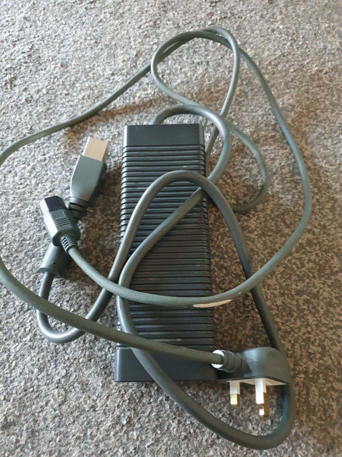

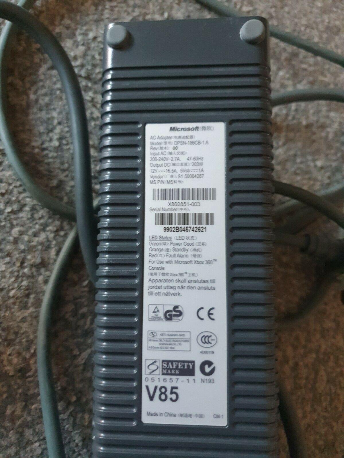

I use an old xbox 360 power brick to power my setup.
It outputs 12V at 16.5amps which is more than enough for all the modules.
